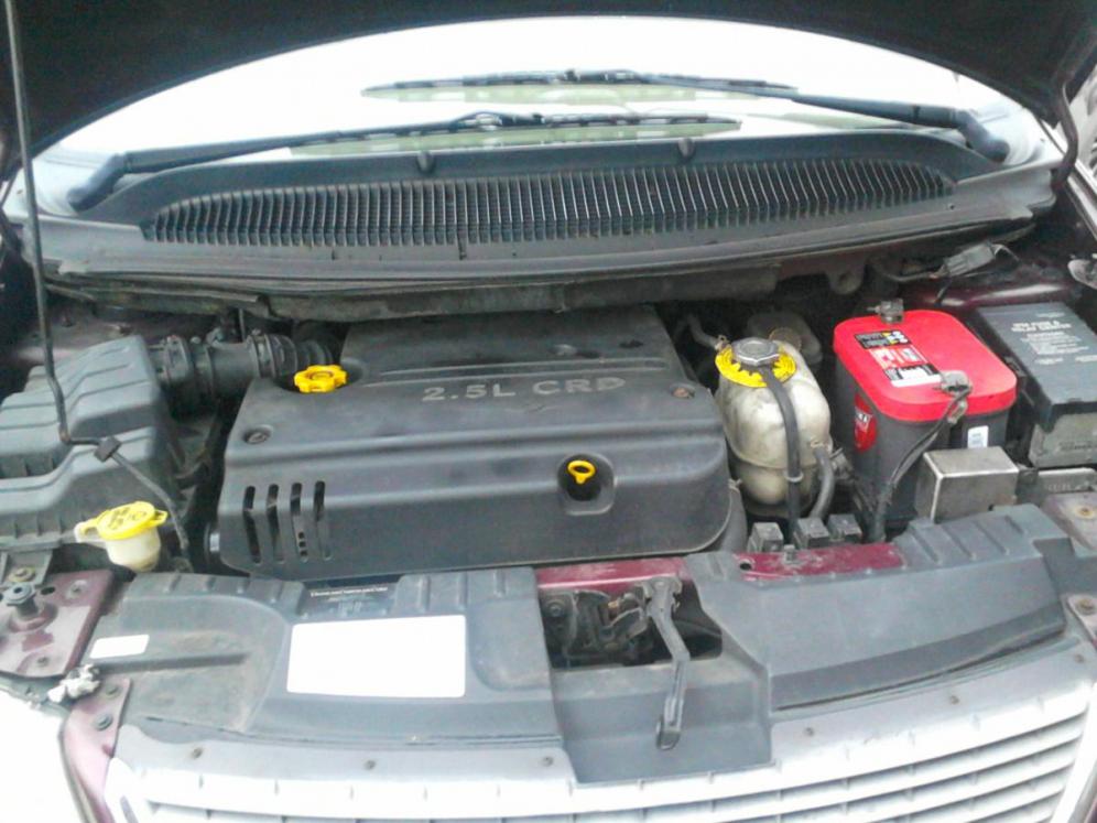

My question is where do i disconnect the pipe to spray into
I am assuming air intake is that pipe next to the engine oil filler cap

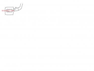

look to the left hand side you have the air box , connected to that you have the MAF sensor , disconnect it where it joins the air box and spray it in there so you are spraying it onto the MAF sensor first then through into the air intake
see picture sorry about the size , first time I have done this
