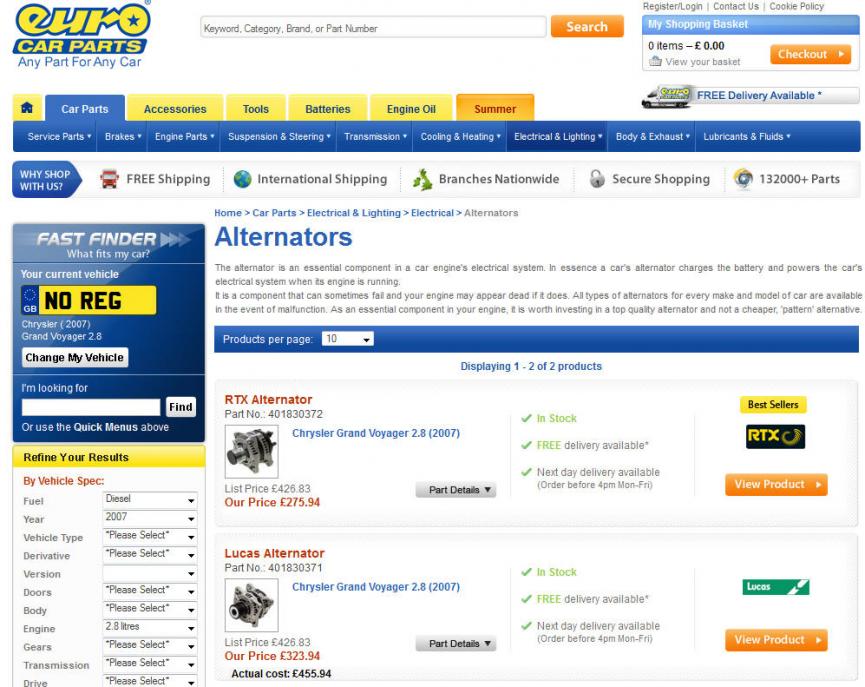

You can get new alternators for less than that, see Eurocarparts as an example, and you could probably get a good used one for a lot less from an on-line breakers.
Attached Thumbnails First electrical problem.. :-(-alternator.jpg
