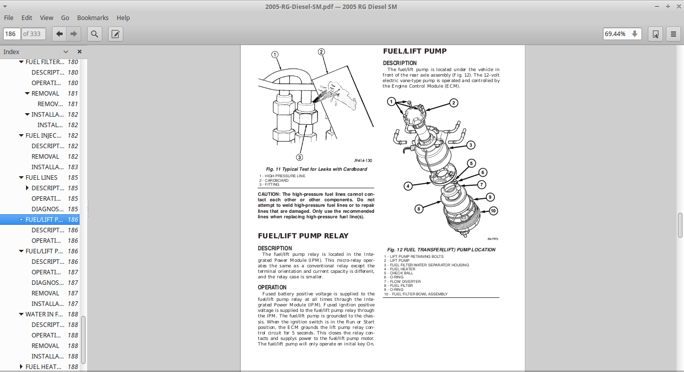

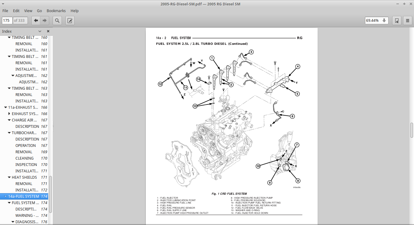

Through other replies and looking into the fuel system for another person I've done more reading on how the lift pump runs, etc.
The lift pump runs on what appears to be a simple timer as there isn't a pressure switch on the low-pressure side. They all appear to run between 7 and 10 seconds before automatically cutting out.
I'm wondering if you've got a slow leak somewhere, so when it sits for a while, it drains back/gets air in and struggles to start.
On a cold start (after long sitting) turn ignition key to on (so plug lights on and pump starts), wait for pump to cut out. Then turn ignition key off. Repeat that I'd say 5-10 times (As though you were priming it after changing the fuel filter) and then try to start. See if that changes how it starts. My guess is it'll start better, meaning you've got a slow leak/drain somewhere in your low pressure fuel lines.
Here is the list of components for the fuel rail (Note no low pressure switch, only high pressure):
And the associated info on the pump relay and how the IPM supplies power for a short time only at initial ignition on:
See how you get on and see if it helps at all.
