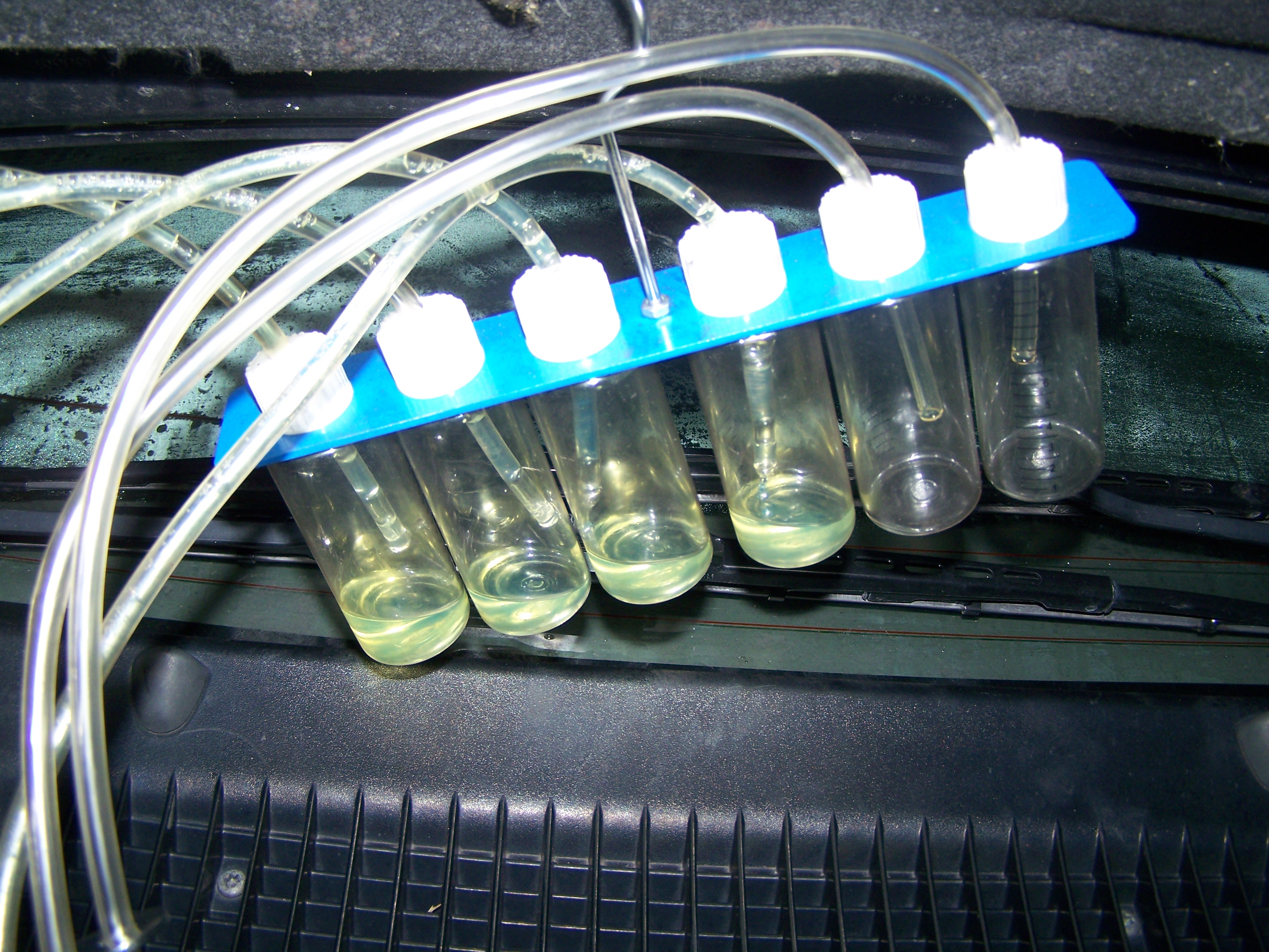

thanks for your help budy , now i have cleaned out the tank and new filter it seems to run smother [ clean fuel ] but when i start it from cold after standing for a day or so , i still get a slight misfire and a small cloud of smoke , i have been told that the fuel could be running back , i done a leak off test last week again from cold , number one cylinder started to rise up the pipe as soon as i started the engine it took around 5 seconds for the other 3 to start climbing , after 4 seconds number 1had a little more in then the other 3, if the fuel is running back what would this be , could this be the pump , also it does run smoother , but i still do not have full power from a stand still , i am going to do another leak off test this weekend as advised , from warm to see if number 1 still climbs before the rest if it does the injector is at fault

Well that's a tell tale if one is leaking more than the other. Poor starting is accrued to not getting pressure up in the rail quickly when cranking due to leak offs. So looks like a replacement injector required or get the four overhauled. Fuel running back on here may be air leak in fuel filter casing where wires enter, slack bowl or bad seal.

i had the 4 injectors reconditioned when i brought the car last year budy , but it as not run right since , a couple of months after i had them done i took them back , they said one was at fault so they gave me another one , but it still is not right , i am trying to check everything else before i go down that route again , thats why i took the fuel tank off friday and cleaned it all out , i changed the filter and all the leak off pipes from the injectors down to the pump
