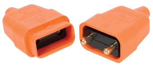

Just mount the mains in the front, or anywhere close to where you put the heater can, it makes you life easy and looks just as good. One of the two air-scoops will do just make sure you have a wet-proof cover. Alternately mount in the engine-bay and put a 13a rubber connector tail somewhere handy, that way its safe, instant, and no messing with opening bonnet or cabling an entire car length.
