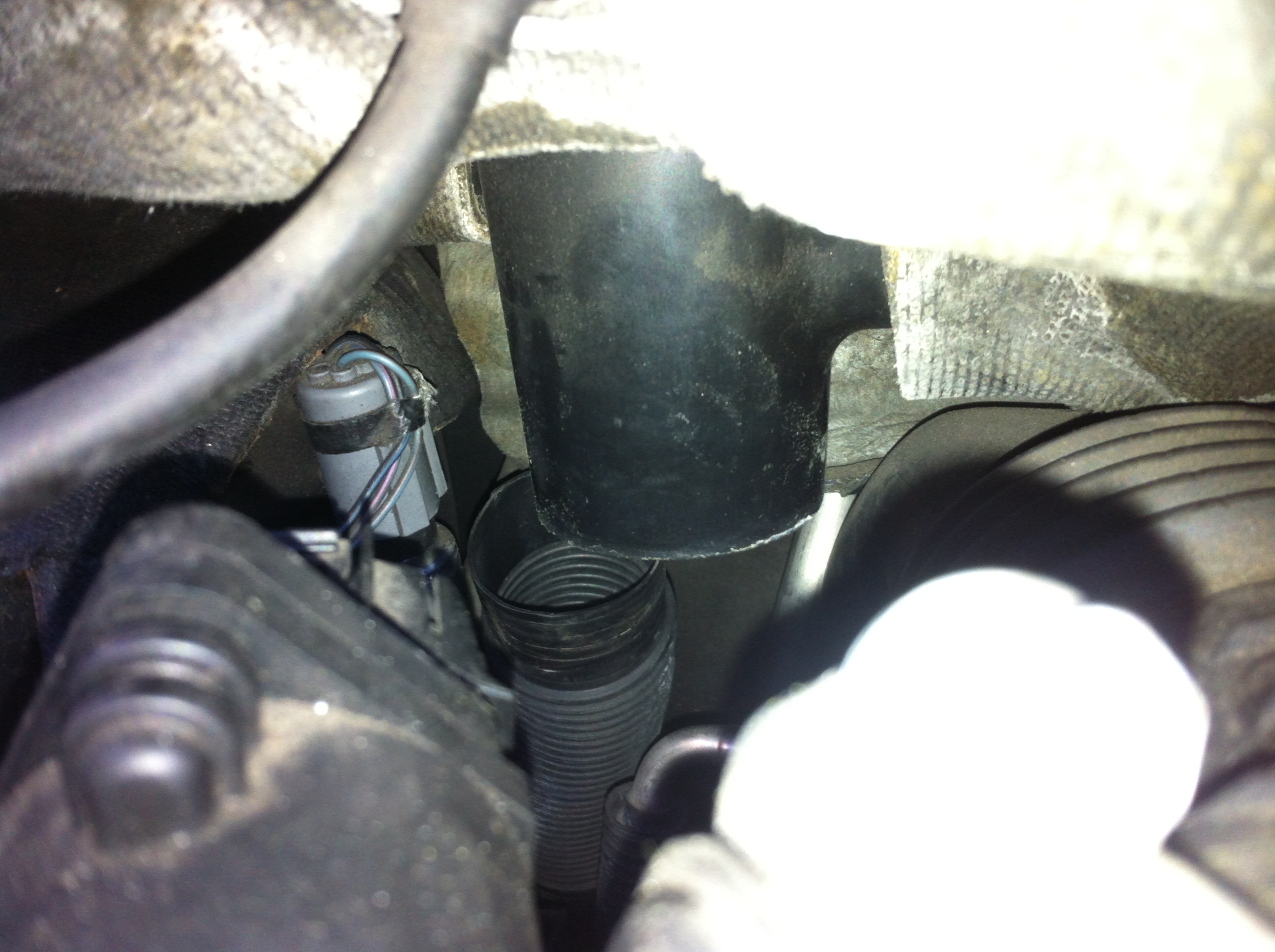

Default Grand Voyager 2.8 CRD diesel consumption super High
Hi,
Where i can find in engine coolant sensor?
Behind the air filter i discovered two unpluged hoses any ide whats that for?
Please see the pictures
Attached Thumbnails Grand Voyager 2.8 CRD diesel consumption super High-photo-1.jpg   Grand Voyager 2.8 CRD diesel consumption super High-photo-2.jpg
