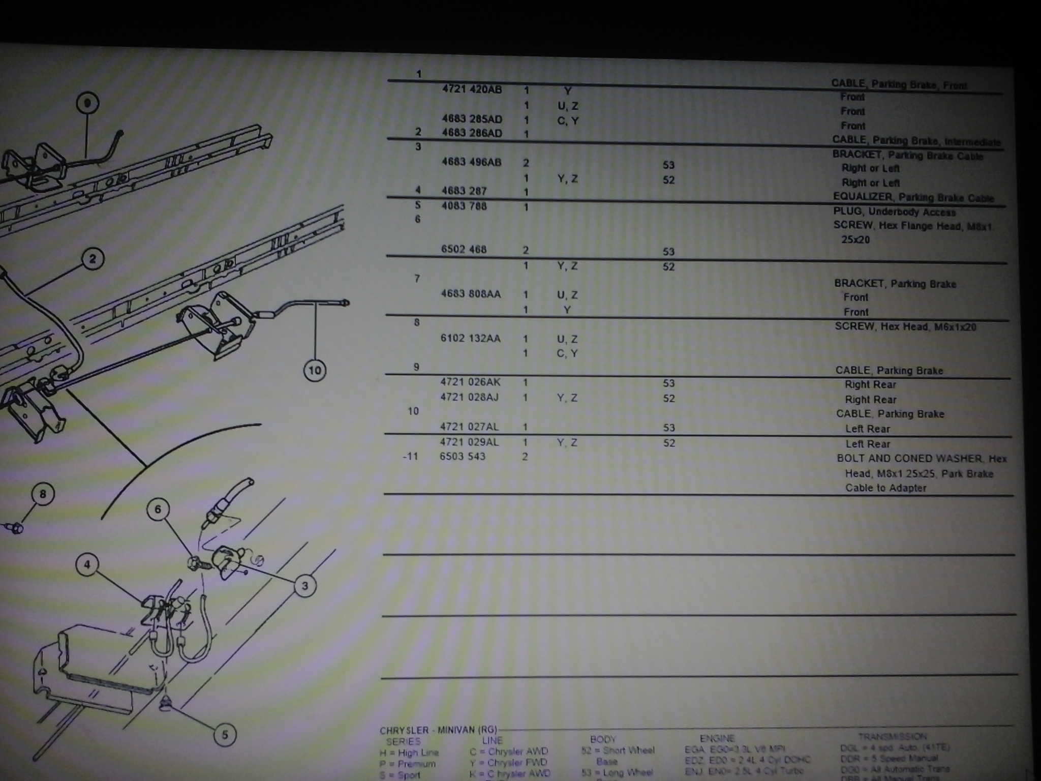

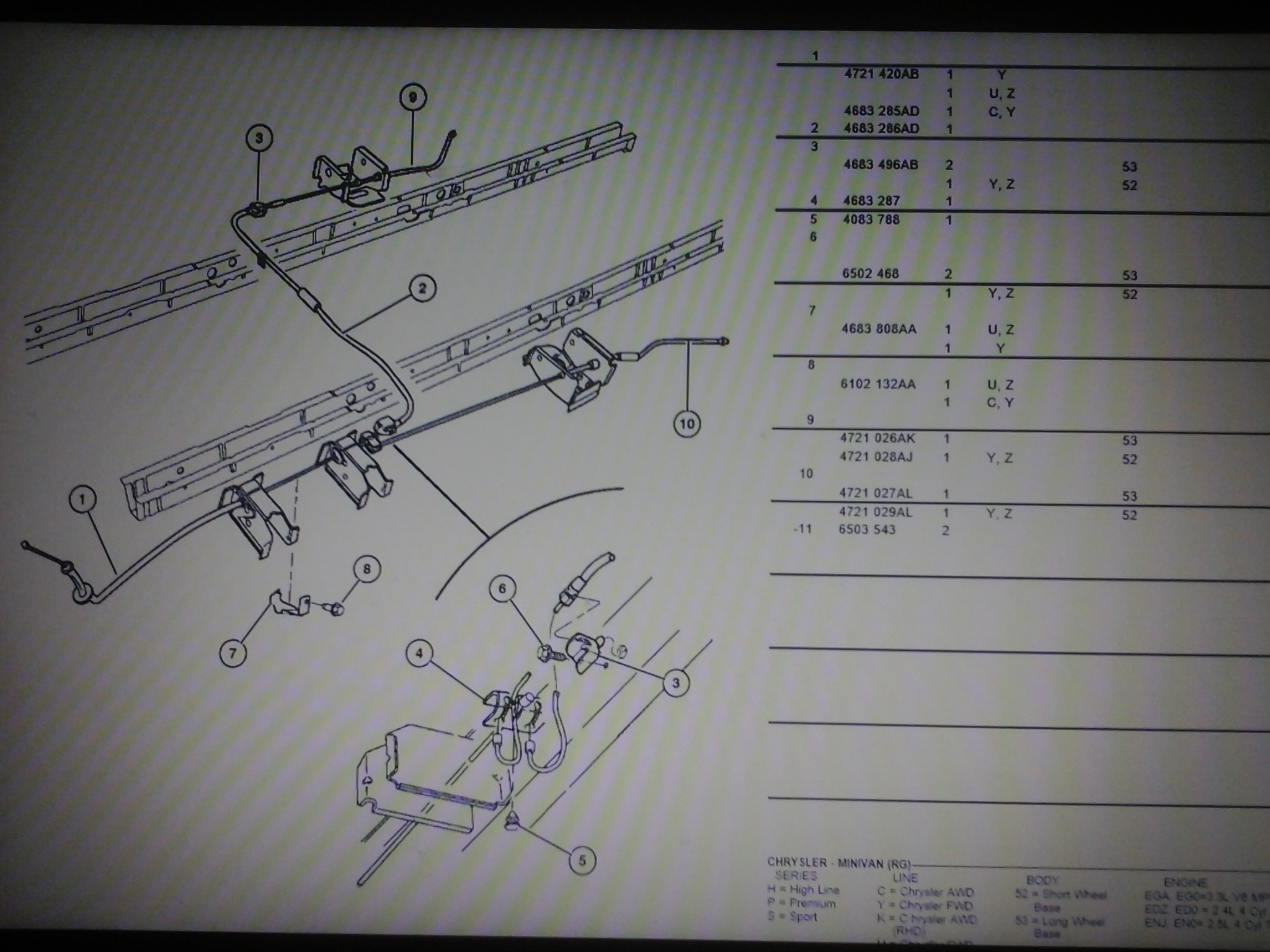

Your handbrake probably isn't holding because shoes are either needing replaced or adjustment between left and right shoes are out. For this handbrake to work and hold car on a hill for example the left and right shoes must be applying and pressurising the inner drum at the same time. The problem with this car is one brake cable is longer than the other so equal adjustment over left/right does not set the handbrake. only adjusting by setting one wheel to lockup on so many handbrake clicks then setting other to lockup on same set of clicks will work.
Do you have a parts manual for your car. See pics for up too 2004 model.

Handbrick is almost never cables and it comes after the letter Z in the list of things to do first. As Goggsy says its replacement parts & adjustment first. Plenty of handbrake posts, pics and even walk-through on this forum by Leedsman & others.
Having a look [20 minutes a wheel] inside the top-hat is the first and essential start point. Best of luck.
