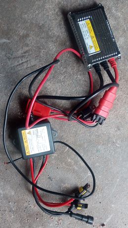

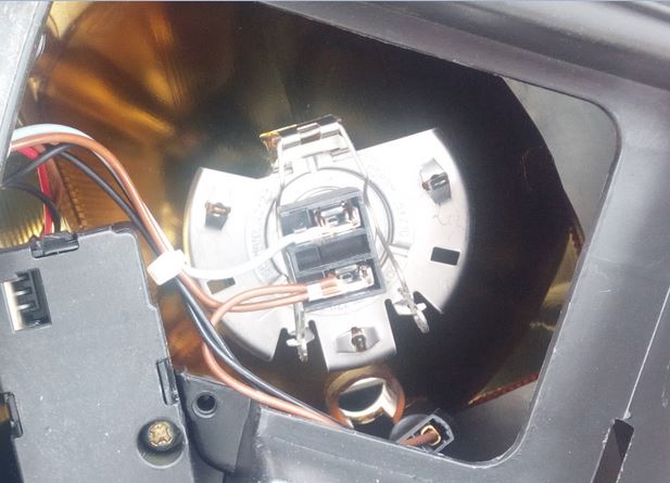

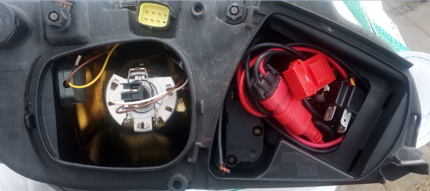

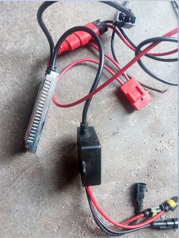

Since you were interested, I crammed a ballast into the housing and took some pics, just for show, not the real assembly. The first one is with the ballast and everything in the housing. The other one shows that there's plenty of room in there. #3 and 4 show the ballast and the RFI attenuator (black). Please note that this one is actually for a H4 bi-xenon with a bigger than usual RFI att and not the one I actually use.
For the cost of 2-3x premium bulbs, you get 4-5 times the light! Just remember that initially, the light ouput is weak in any HID, but in 4-5 secs you have full output.
The one I use is a 50 W HID, not the standard 35 W, but that one will obviously also produce quite some light.
