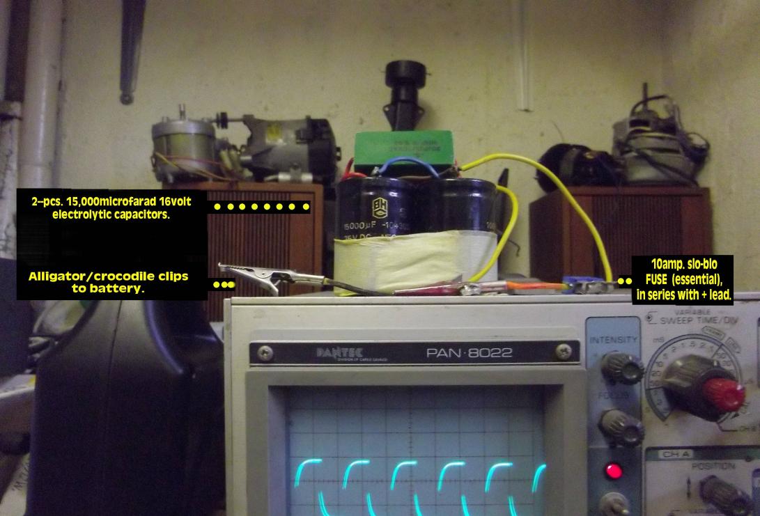

Rather than sweat trying to locate and replace these capacitors, it's a lot easier to simply wire one across the battery (with the essential safety fuse in the + lead). I have included a picture of my Mk. I version. I had to use two times 15,000 microfarad, as I didn't have any singles. So it's 30,000 microfarads in tot.
As it's hard to prove anything with glitches etc. this is a purely "suck it and see" excercise. No guarantees. If it don't work, it's prob. wasn't glitches. If it does, it was.
Leedsman.
Hope the pix. gets there.

Dude u have got to give up on that wiring in a capacitor to the battery stuff its not going to work.
If u add stuff like that to a car I can promise u there will be more then enough issues that you will create then solve.
