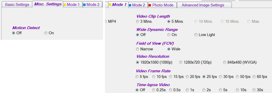

Do you mean your laptop is showing the snapshot pictures, (If so your laptop just isn't up to the job of playing HD movie files) or do you mean your desk top is showing the snapshot pictures?
If so then you've got something wrong in the Mobius settings.
Check the Misc Settings tab to make sure you still haven't got Motion Detect selected.
Also check the Mode 1 tab to make sure you've got Video Frame Rate set to 25 fps and Time-lapse Video set to Off.

Right as too snapshot pictures coming out of Mobius the only thing I can find in the setup is Video Frame Rate was 30 instead of 25. So will that cause it.
This desktop computer I'm on here is like watching paint dry, its memory must be full of junk.
Old Feb 7, 2015 | 04:20 AM
  #39
Nope, that won't cause it.
Does the camera start recording when you connect power to it in the car, or do you have to press one of the buttons to get it to record anything?
Note: It won't start recording when you connect it to a computer, even though the USB is supplying 5v to the camera.
Edit: Are you sure you've set Time-lapse Video set to Off on the Mode 1 page. (You should check the settings on the Mode 2 page as well, just in case)
