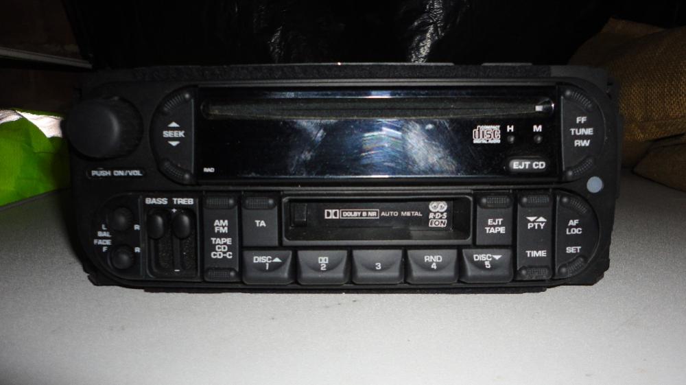

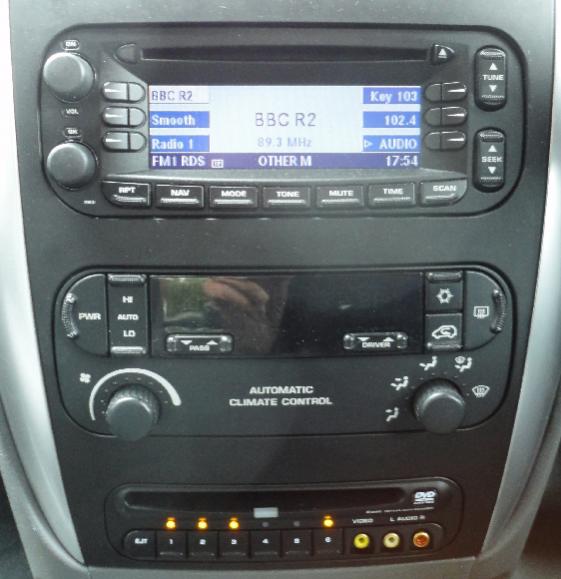

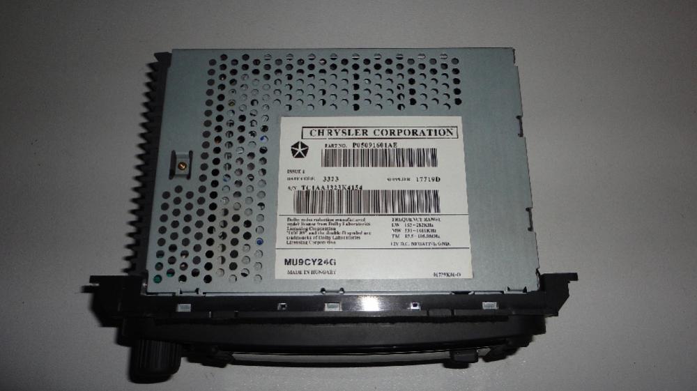

Originally Posted by QinteQ
REK - this is the one that should be in all Euro GV's from 05 onward, and is the one in my car.
I don't understand it then. The first pic is the setup I have in my 2007 GV. The second and third pics are the unit that was originally fitted to my 2004 GV but this was replaced by the dealer because I had the optional SatNav and 6 CD autochanger fitted. I still have the unused RAD unit in my garage because the dealer gave it to me after doing the upgrade.

Yes its confusing, most of any info is only available on American sites and they will never have seen the Euro Wagon spec stereo heads, and would never need to - why would they ! For example there's zero on the REK and yet there must be millions in scrapyards from Belgium to Birmingham, equally there's zero on the REK on any site in the world including Europe which is precisely where in the world they were all shipped to and sold in, and in the case of the REK Chrysler broke their own golden 3 letter rule and did not put the sales code on the front of the set.
Its difficult to make out the three letter sales code on you pic #2 but whatever it is its clearly a version of the RAZ additionally the head [pic #3] seems to have been manufactured in Hungary not Huntsville. The RBU and RAZ are almost completely identical in appearance. Every single button and control is the same (except that the Eject button is above or below the time setting buttons); the graphics are identical but in different locations. You’d never know the RAZ was a Mitsubishi while the RBU is an Alpine. (Jim Z. also noted that the RBU is the same as the RBP stereo, except the RBU has dual play capability and a transmitter for headphones, so you can play the radio over the speakers while listening to a CD on headphones. That means I could just as easily have used an RBP.)
So in your Pic #1 the only item that's the same as mine is the unrelated zone controlled climate set. Even the Chrysler-Delphi 6 disk changer with the AV inputs is different to mine and again seems not to exist anywhere on the interwibble.
