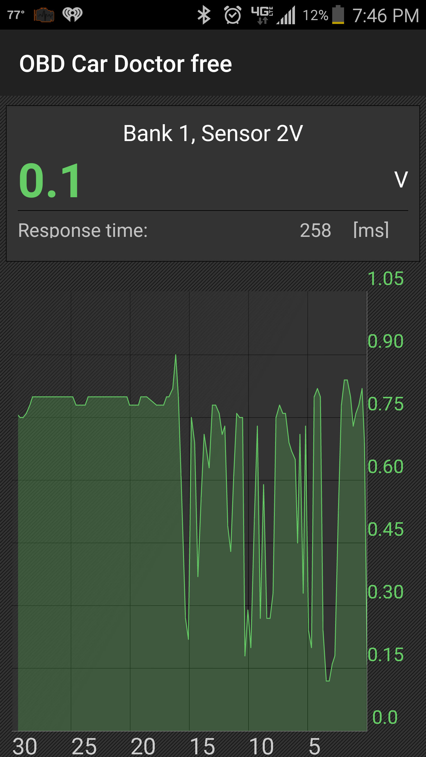

So my wife's 2006 town and Country is reading code p0420. I have a scan tool and I am trying to troubleshoot the issue but need help. I have attached screens hots but would appreciate any input to help figure out if the issue is O2 sensor and which if so or catalytic converter.
Attached Thumbnails Need help with p0420-screenshot_2016-05-07-23-32-32.png   Need help with p0420-screenshot_2016-05-07-19-50-08.png   Need help with p0420-screenshot_2016-05-07-19-48-52.png   Need help with p0420-screenshot_2016-05-07-19-47-00.png   Need help with p0420-screenshot_2016-05-06-19-24-08.png

Second The o2 sensors are doing there jobs thats why u have the 420 code.
The computer uses all 4 sensors to make the determination that the converter is not doing its job.
