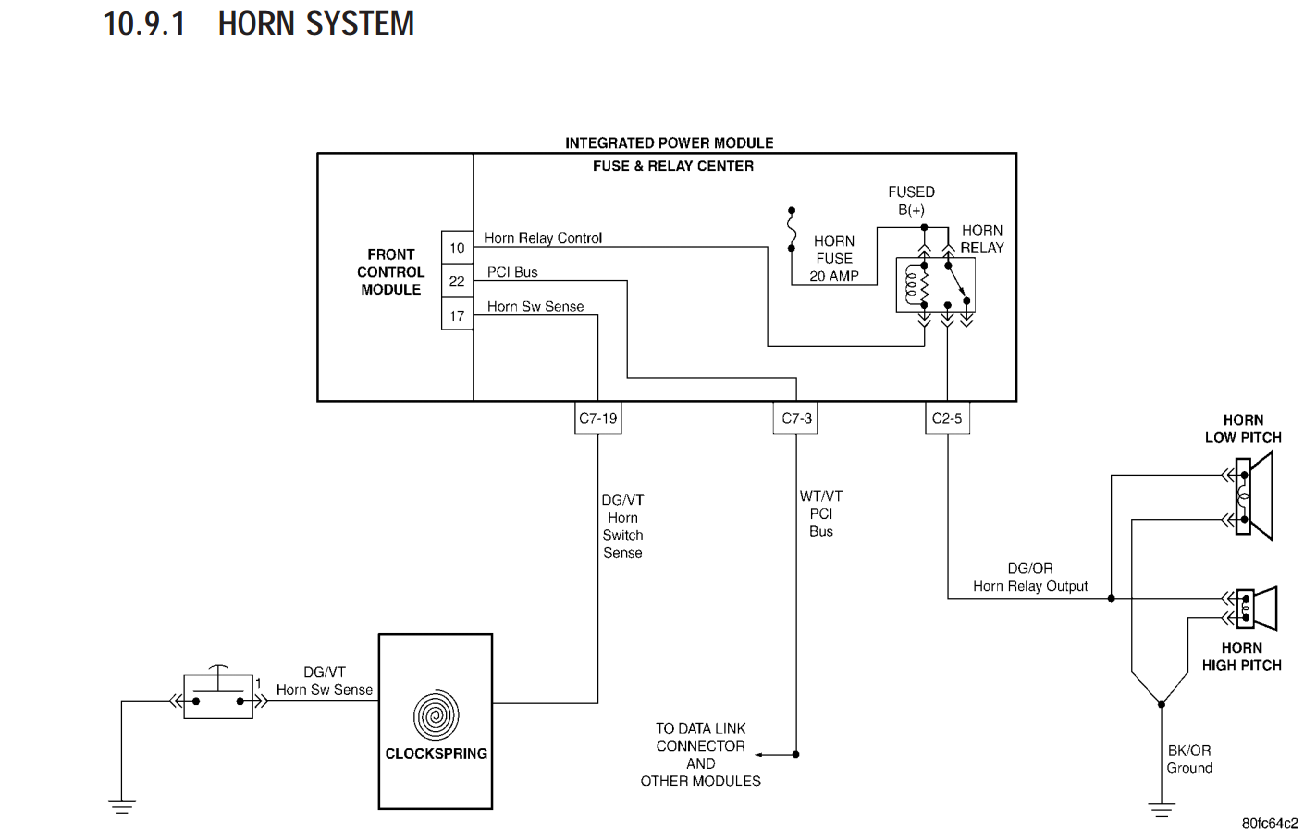

On my 2005 the PCM is also the ECM ECU - they are all the same thing just different names my friend for engine control
( I invented this question ) What has parts darts from your #7 quote to do with this ?
Parts darts is what lazy ~ or inadequately skilled ~ or sometimes just frustrated engineers / technicians / mechanics do when they throw your money at their inadequacies in the hope only that they will get a 'bullseye' without any proof that that particular part will cure the problem. They change a $500 or £500 part without 1st proving the part is bad, when what the rule should be is """ if you can’t prove the part is bad, don’t replace it.”""" So don't just agree to the £500-£1500 gamble without first asking pointedly have you proved the PCM / IPM / FCM / ECU to be actually bad before you spend my money ? - after all it might just be, and often is, bad COMMS between the PCi and any of the PCM / IPM / FCM / ECU and no parts need to be replaced.
__________________________________________________ __________
The TCM and the TCU ECU - are all the same thing just different names my friend for transmission control
The IPM is a posh name for a fusebox and connects directly to the battery, as I said a crossroads, an exchange site for power distribution instructions, for example when you turn on your fog lights or number plate lights your switch sends a message to the IPM and the IPM relays the message to the light bulb. Its also well known for mysterious airbag non-deployment, fires, stalling, unintended acceleration, headlamp problems, damage to other components and subsequent lawsuits.
The IOD [fuse] in the IPM controls the digital clock, remote key fob, radio, heater, mirrors, central locking, power seat etc.
The FCM [front control module] is the alloy box mated to the front of the IPM, not connected directly to the battery but controls power to many of the GV's systems [we are in computer talk area now] what you need to know is the FCM interacts between the IPM and the PCi computer data BUS on the vehicle. If you want more on this specific read the workshop manual - its too long to post here, but to give you some idea of the complexity of the data it handles the following functions are controlled by the Front Control Module:

Finally as an example of why the IPM / FCM can influence seemingly unconnected bits of the GV lets look at probably the simplest, most schoolboy level part, the horn. you can see in the above pic that what people think of as a bog standard fusebox is in fact also part of a computer communications system.
I hope this helps rather than confuses you darkcild101.
