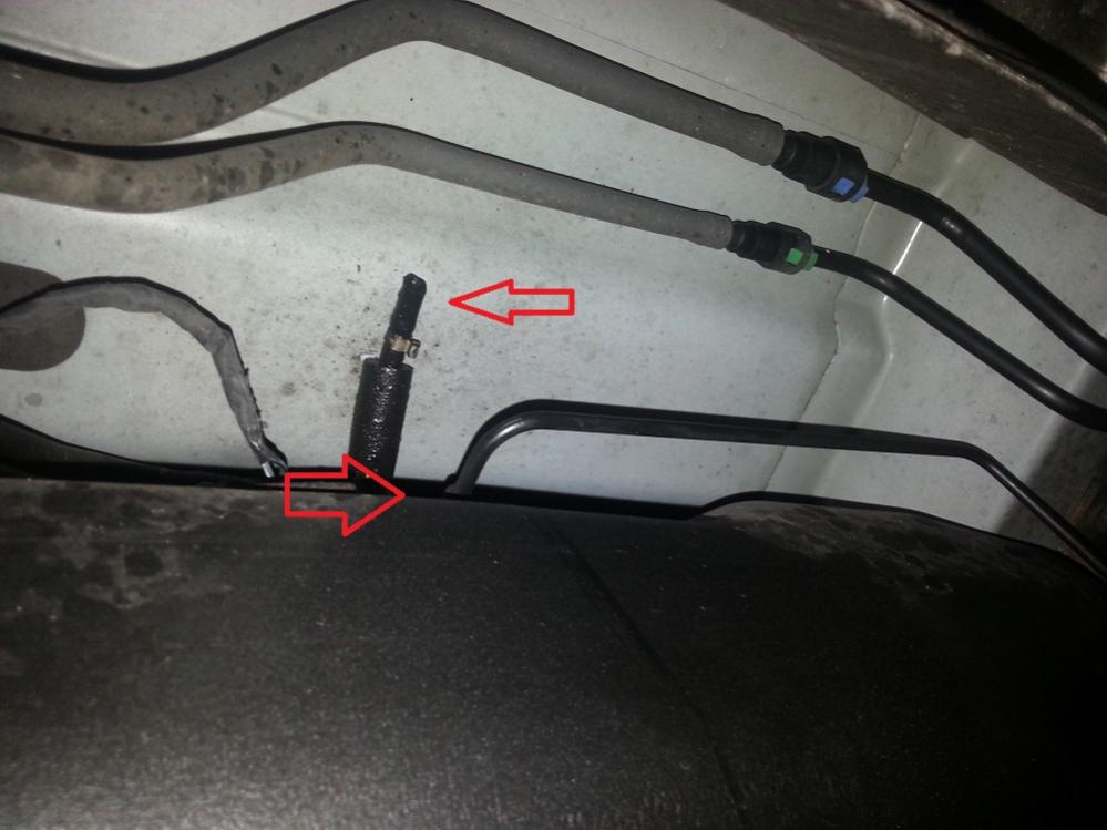

Like I also posted in another thread, my 2002 2.5CRD was in the garage on the bridge this morning for new front sway bar bushings when I noticed a fuel line hanging loose..
The mechanic looked at it and re-attached the fuel line. He explained to me this was the fuel line for the aux heater.. I found this thread and now I am curious if it is still working..
Am I right to assume the heater fully automatically starts working when:
  • It's cold outside ( like <10 Celsius)
  • Engine is cold
  • Interior heater is set on high
Are there other methods to test the heater or anyway find out if its working?

Yup thx, I found the heater (or DCHA as it seems to be called) already.
I even found most info I was looking for in the manual..
Now the only thing I am wondering about is that the heater gets switched off when unable to run multiple times in a row (like in my car because the fuel line was disconnected): "If six
continuous attempts to start the heater fail due to
one or more faults in the DCHA system, the heater
enters a heater lockout mode."
Would that mean I have to reset the Car Computer by disconnecting the battery for a minute or so? Or would the "DHCA" detect it can resume normal operation now I connected the fuel line again?

Today I looked at the DCHA, and all is connected well..
Fuel lines, ok, wiring harness looks ok, connectors ok, the whole DCHA assembly looks ok for the naked eye.
I did the keydance and only a errorcode about the FOB key turned up..
Also all conditions to start the DCHA according to the manual are met as far as I can tell.
But the heater is not working.
Now I found a "heater relay" in the relay/fusion box. Could that one be broken and can that easily be replaced? Anyone any experience with that?
