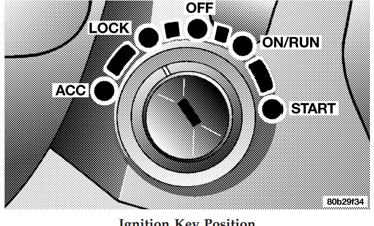

The key dance is the below.
The dance is the timing [knack] between moves in milliseconds between the OFF and ON position. Brain in gear, patience, it works in milliseconds, practice. NOTE that the OFF is one clockwise from the LOCK position and the LOCK position is the only position from which you can withdraw or insert the key into the barrel.
- its (1) On / Off (2) On / Off (3) On / Off (4) On
- different car but exactly the same mode operandi

Because the ignition switch is different, the key dance is slightly different on the 2008 and up minivans. The sequence is:
(1) ACC / ON (2) ACC / ON (3) ACC / ON
George
