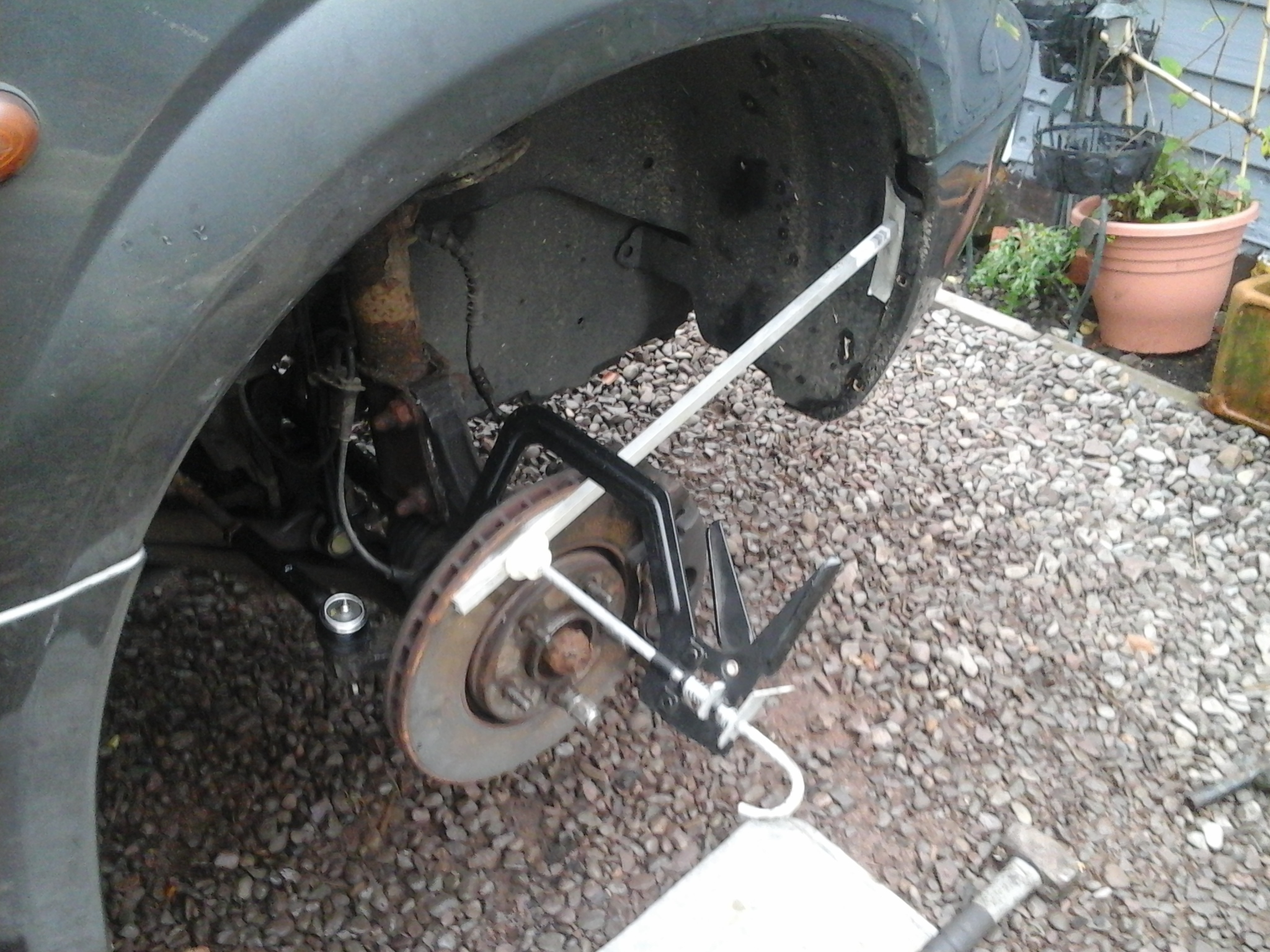

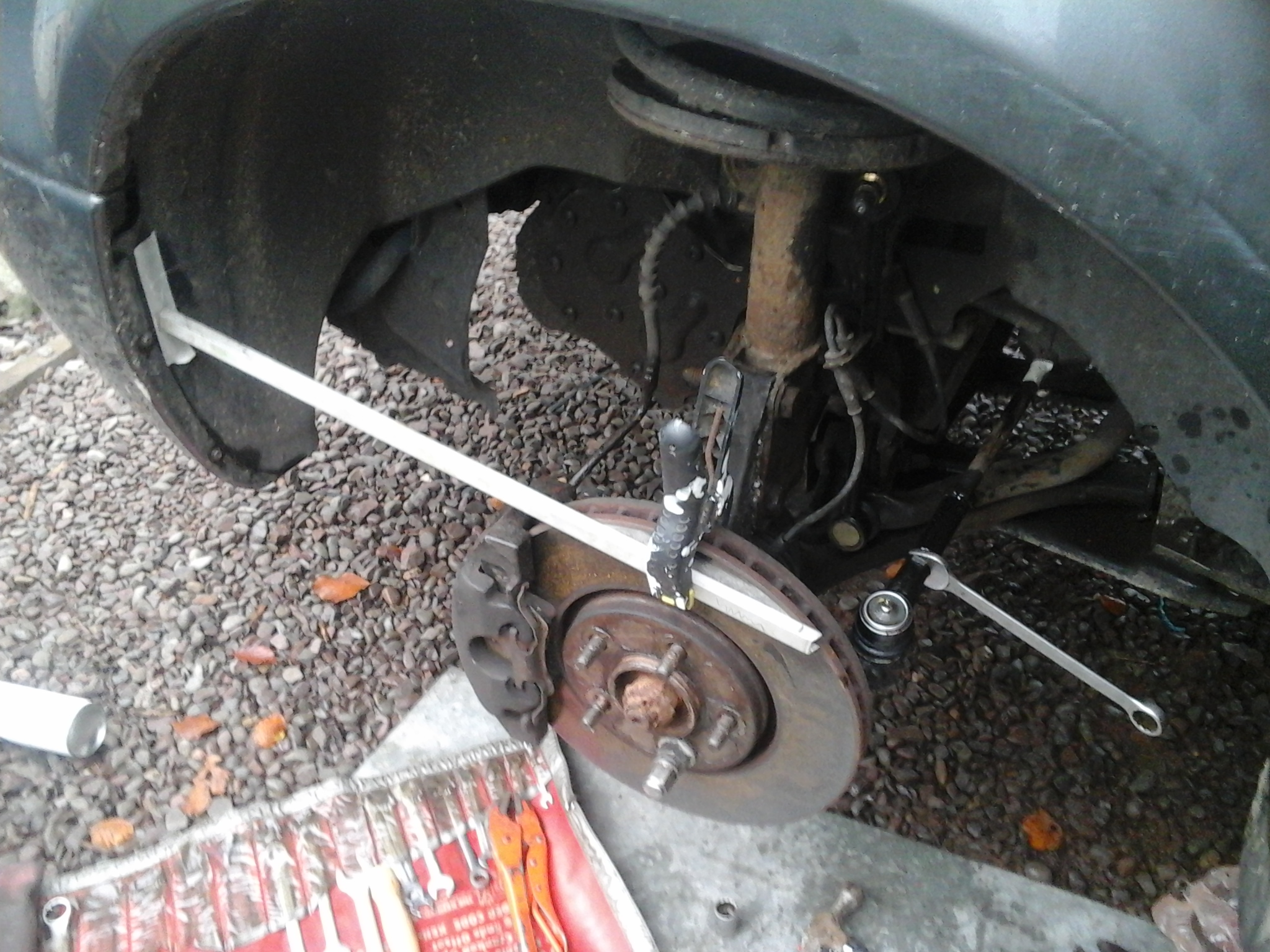

Try and make it simple as my Broadband goes. See track 1 & 2 these aid in keeping your tracking right or how it was. But lock disc to hub with nut so it does not wobble. I used Aluminium u bar with masking tape inside wheel well. Loosen ball joints with separator or one or two hammers.
Oh and got mine from Jeep Chrysler parts about £25 the pair.
Attached Thumbnails Track rod ends and rack ends. Are they easy to replace-chrysler-voyager-track-1.jpg   Track rod ends and rack ends. Are they easy to replace-chrysler-voyager-track-2.jpg   Track rod ends and rack ends. Are they easy to replace-chrysler-voyager-track-3.jpg

Count the turns of treads off, and same number of turns on gets you to the same place they were before you started. So assuming the tracking and toe-in was correct before you started - that's how you should finish. Or yellow marker paint it or white tape round it or measure with a ruler or Goggsy trick etc - they all work. Best of luck.
