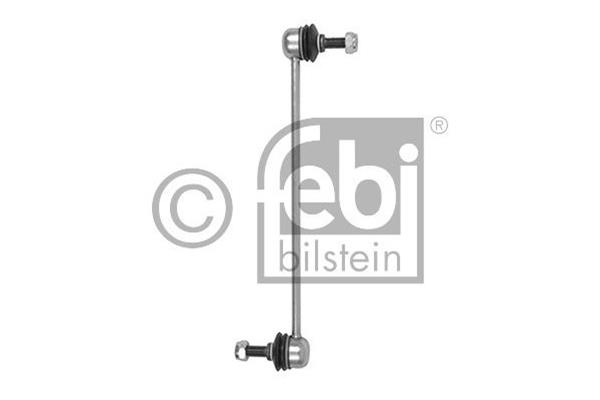

Could be your stabilisation bars and/or the rubbers of the front sway bar, I changed mine and I lost the "clunck clunck" sound on rough roads and the car steers 250% better and straigther.

Dunno the rubbers where black
My GV steers a LOT better/straight since I changed the stabilisation bars, but I indeed don't know if it can influence the tracking tho...
