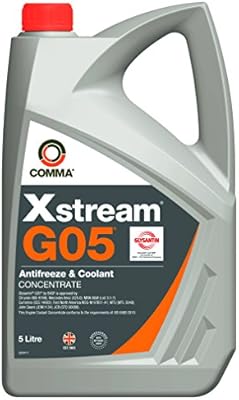

Old Sep 24, 2020 | 12:16 PM
Comma XHD5L 5L Xstream G05 Antifreeze and Coolant Concentrate
  1. "><img src=" /> ">

Thank you for that
Old Sep 25, 2020 | 05:23 AM
Amazon delivered quickly, perfect.
