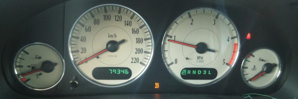

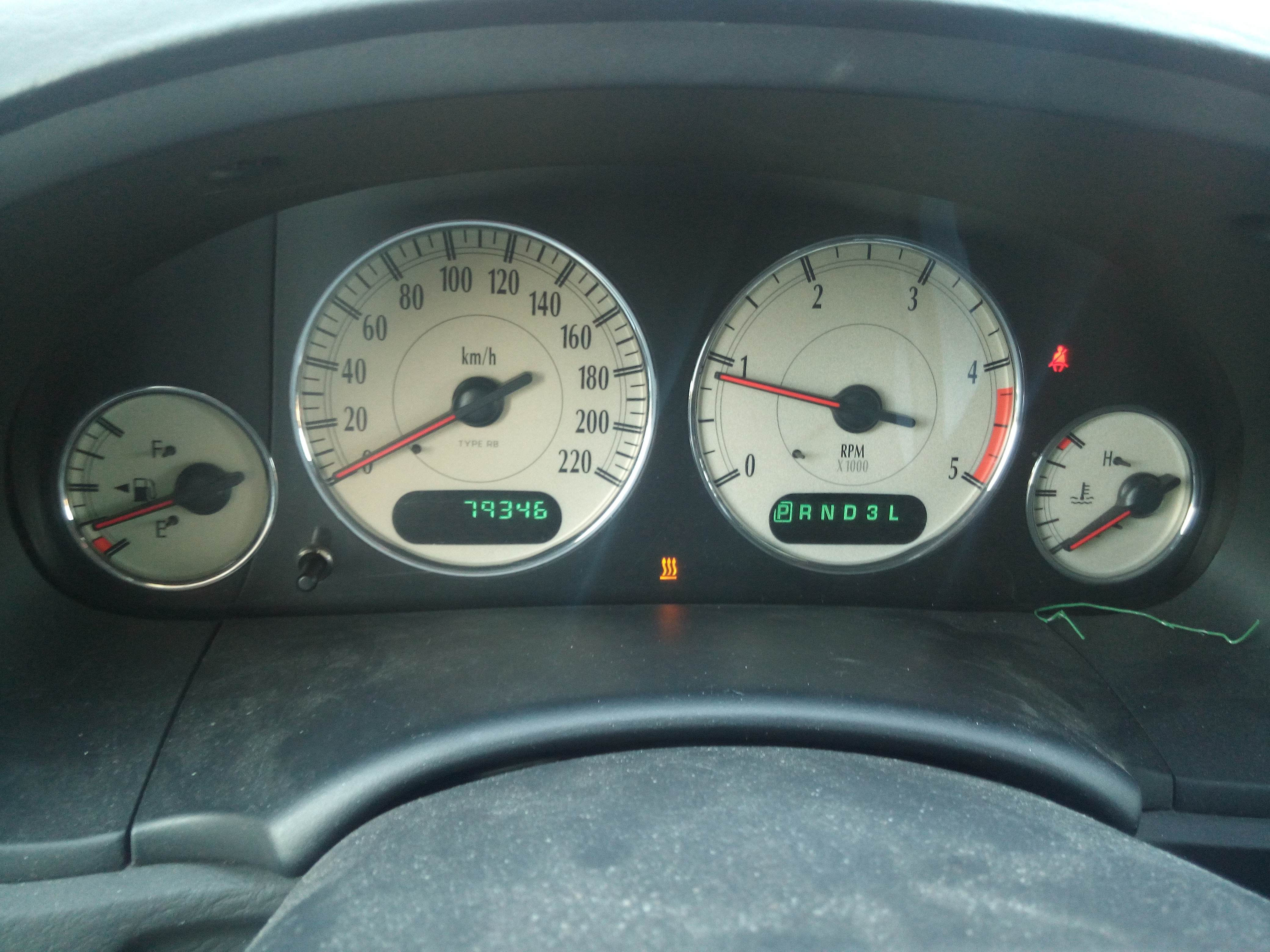

Hello,
I attach a picture of my panel . You can see a yellow ligth in the bottom and centre. What does it means?
It gets on when I start with cold engine, and get off later.
I do not have the rigth manual and I can not find it.
My model is Vojager CRD LX 2.9.
Can someone send me the right manual?

That is the axillary heater I think.
A heater under the left side of the car, which only starts if its very cold end there's enough diesel in the tank.
It heats the cooling fluids to get the engine on working temp much faster.
Methinks

Its not in the workshop manual or the owners handbook, it is as vmaxxer says a Webasto, you have one of these under your car :

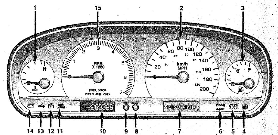

I have a user manual that it isn't for my model.
I attach the shema of instrument panel that is showed in my user manual: it is different from the instrument panel of my car (view other attachment).
Does it exist a user manual that shows the same instrument panel of my car?
