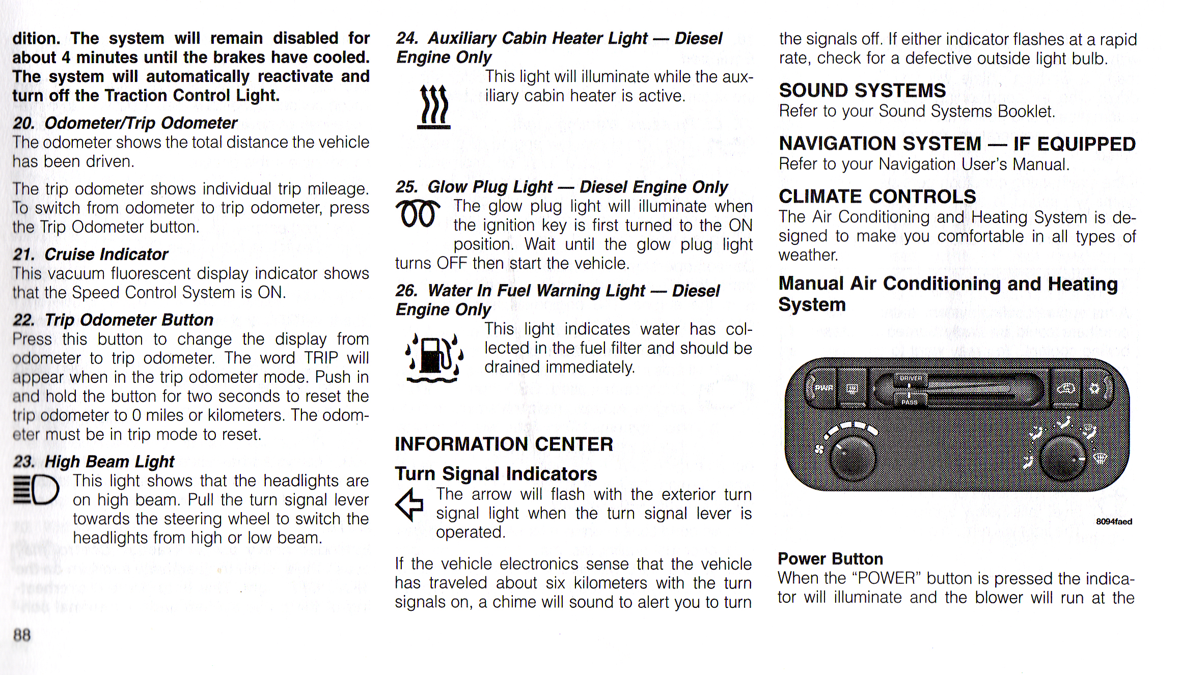

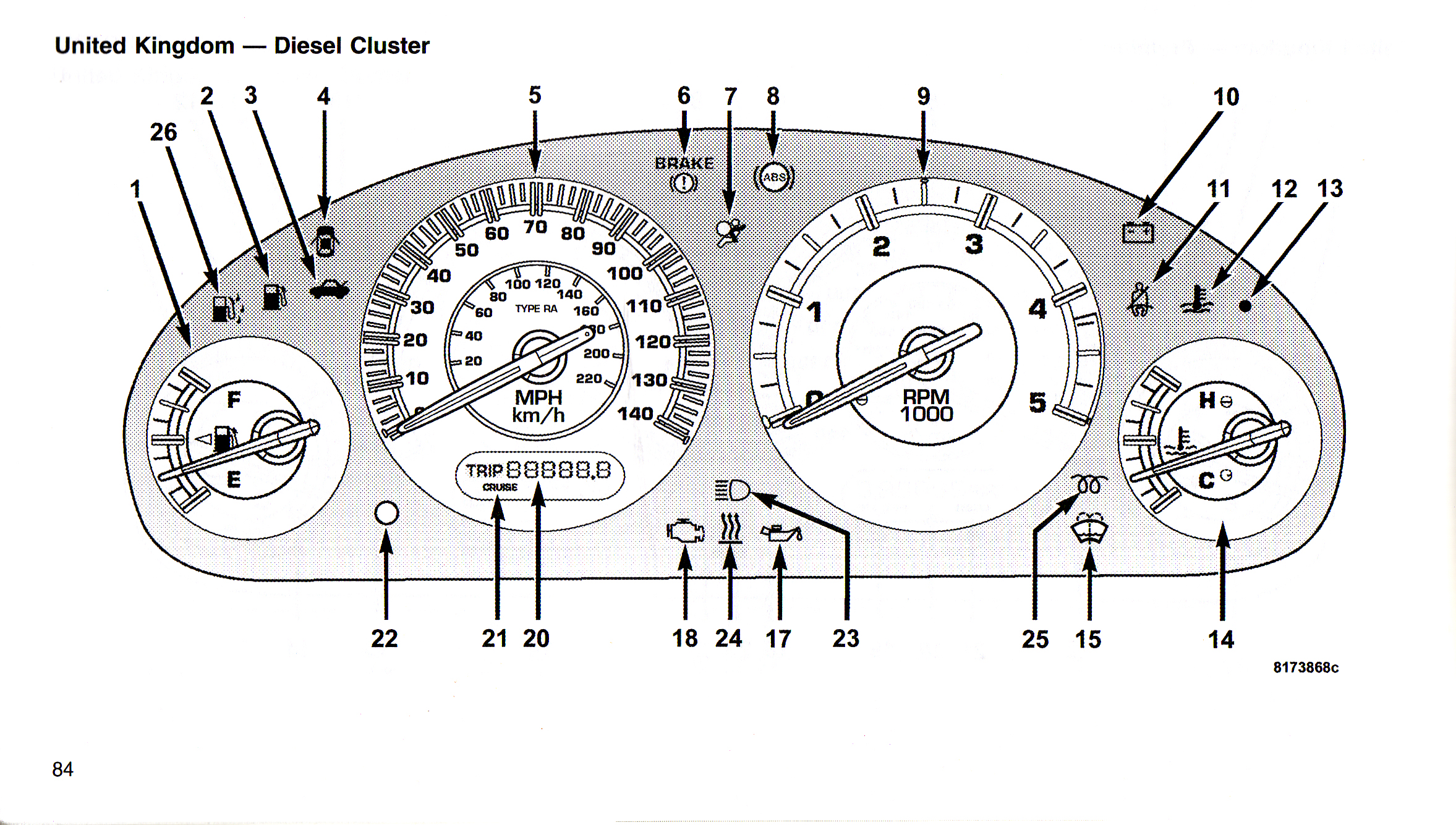

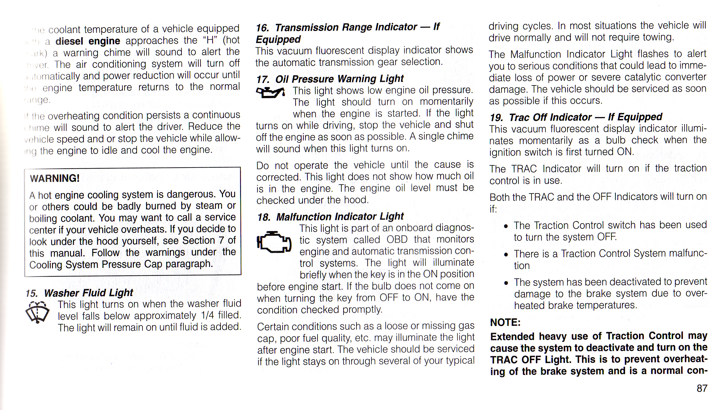

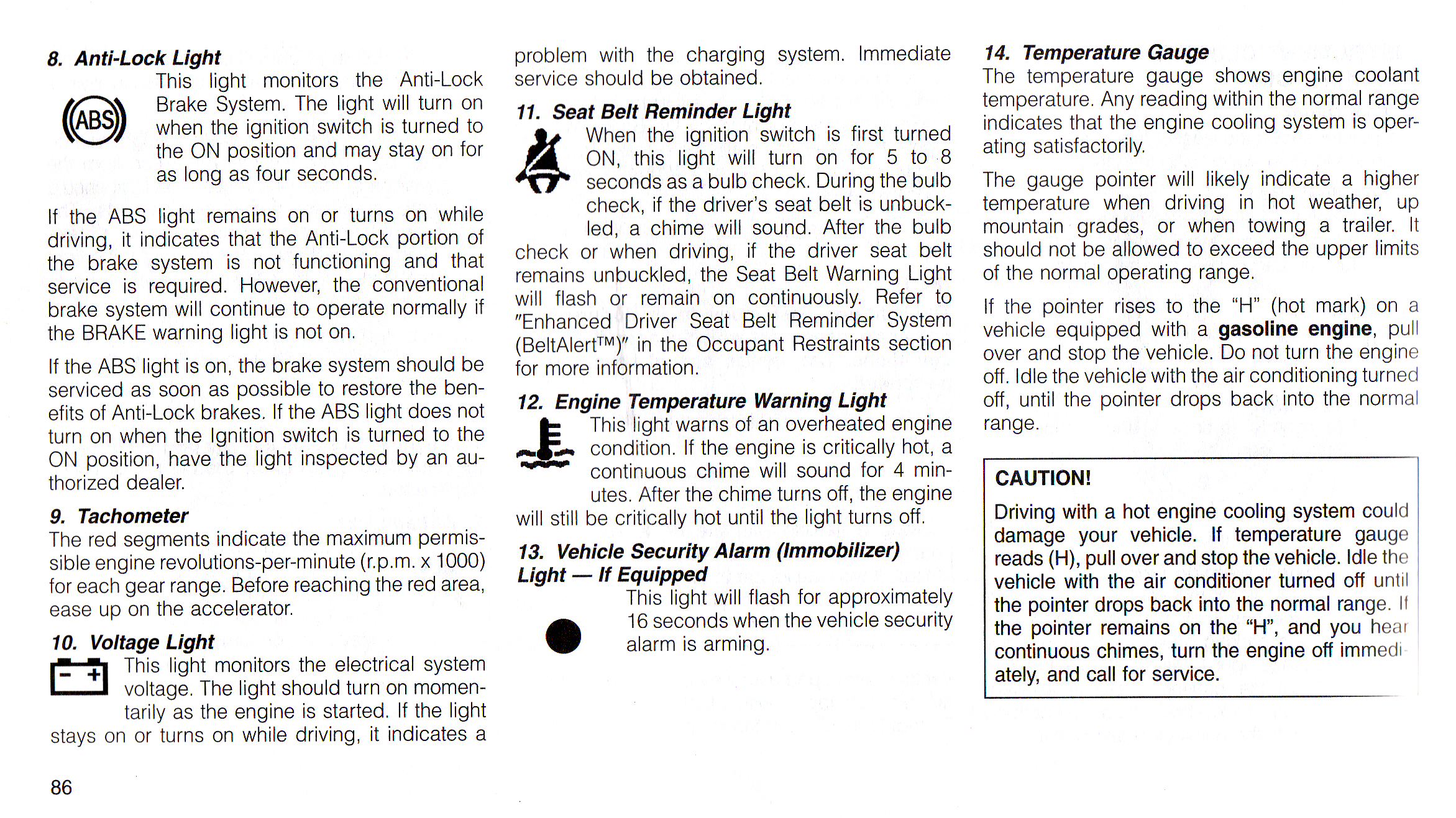

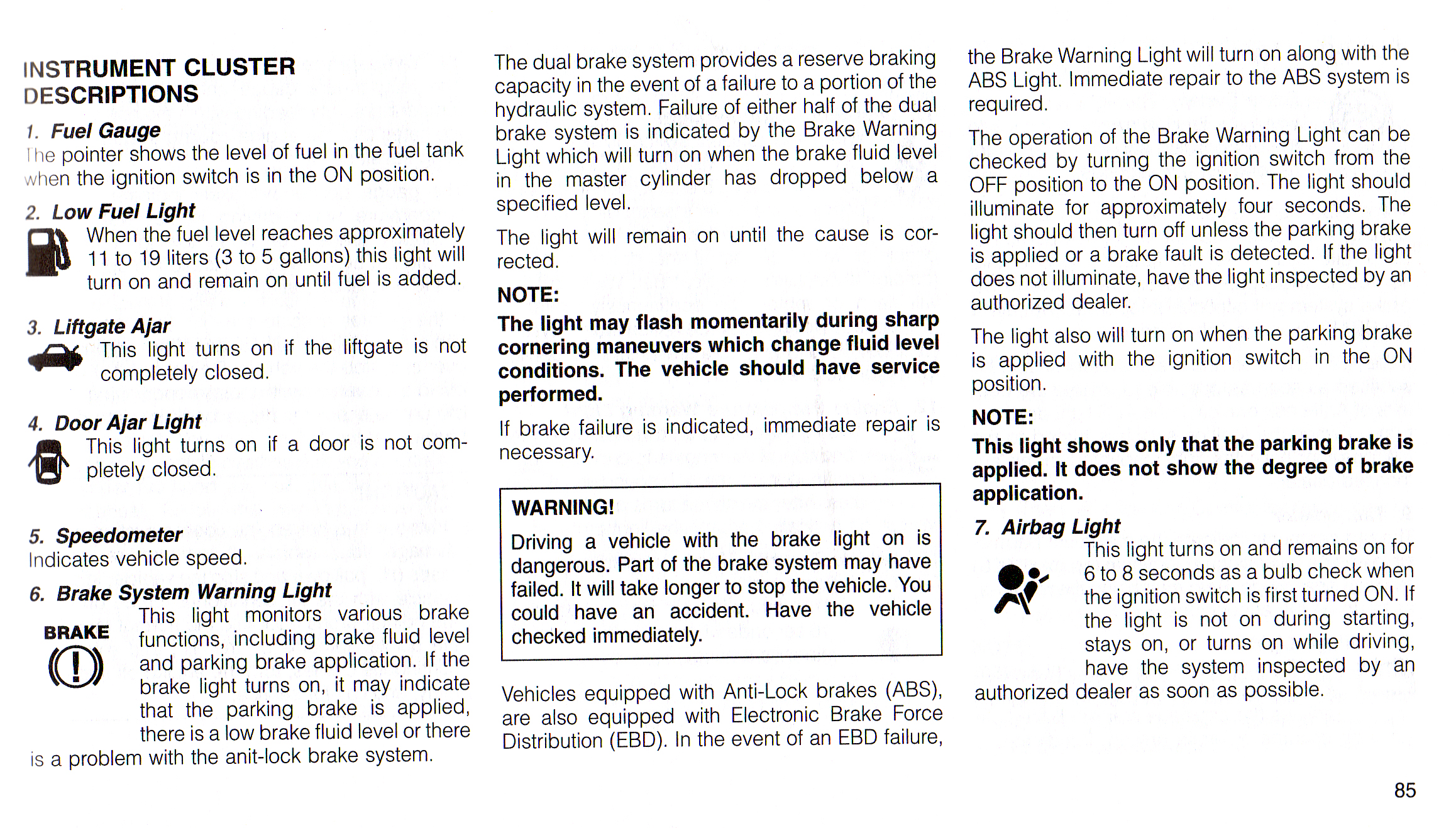

Here are the relevant pages from my Operating Information booklet.
