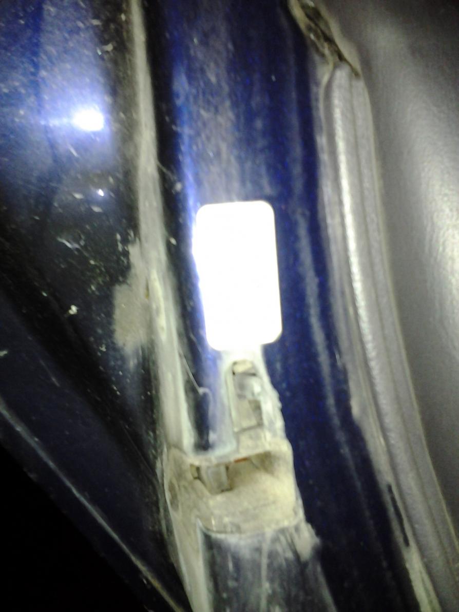

Perhaps I'm not understanding correctly, given that i for whatever reason can't view the picture you linked. Are you referring to the lever found on the edge of the door that you Polk out push up or down to activate it in the first pace? If that's so, then unfortunately i am unable to access this at all at this point, add the door will not open from either inside or outside. Is it possible to re upload the picture so that i can see what you're taking about? Thanks for the reply

I managed to get the driver's side door removed entirely, after getting frustrated and ripping the weather seal right off part of the frame (the part of the frame closest to the back of the car). It was there that I noticed the location of the child lock, which turned out to be not on the EDGE of the door, but on the interior, blocked from access by said weather stripping.
Interesting thing: the lock wasn't engaged, not on either side. So, this brings me to a different angle of attack on this issue. I've removed the exterior handles so as to study the mechanism behind how they actually open the door (discovered that the bracket responsible for pushing the release bar down snapped in half) and have found that if I roll the window down, reach in and push hard on the lever while absolutely yanking on the door, I can get it to open. The actual lock mechanism, however, tends to stick even after adding a generous amount of lubricant to the inner workings.
