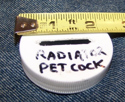

A couple of week ago I was replacing the coolant in a 2004 Sebring sedan. I noticed that the radiator petcock was in reach of my left hand, but I couldn't get my fingers in the right position to loosen it. I saw where some people said to remove the lower radiator hose to get the coolant out, but it sits about 6 inches from the bottom, and I wanted to be able to remove as much coolant or water, so I could be sure to get in enough antifreeze to mix with the existng water left in the engine after flushing for a strong enough mixture for freeze protection.
I came up with a tool made from an old vitamin bottle lid with a slot cut into it to fit the handle of the petcock. It is a little under 2.25 " in diameter with a slot @ 1 and 1/8" long by 3/16th's wide.
When you fit it over the petcock, it is easy for your hand to grab it, and the larger size gives you more leverage to twist it open.
I heard some people say sometimes the petcock gets stuck, but in my case it worked out great.
