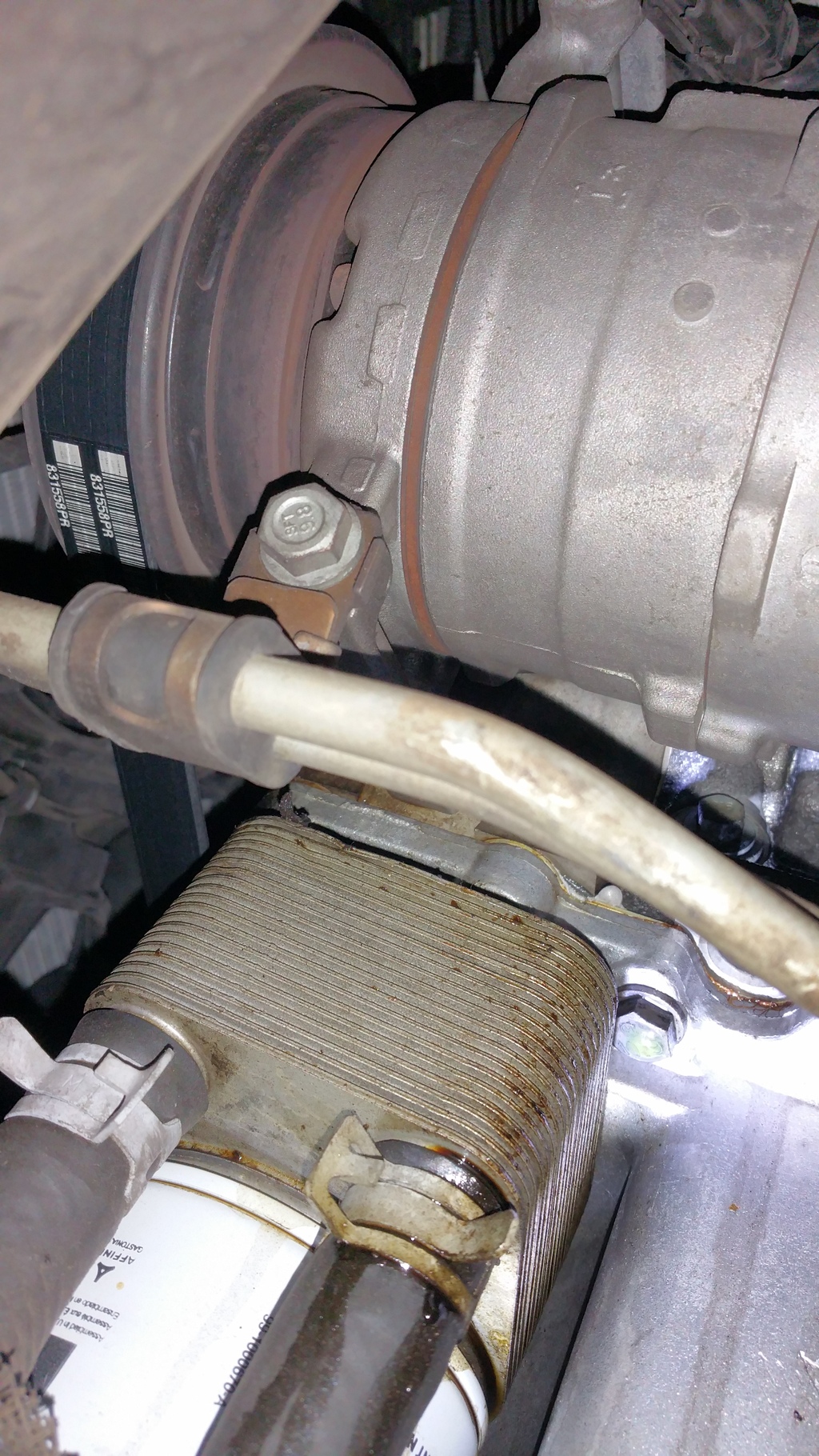

1. Jack this lady up and get a look under the skirt - oooh, she leakin', soakin' wet (and not in any good way).
Looks like oil and coolant leaking over cooling unit, filter and hoses. Bottom of oil pan covered in oil as well.

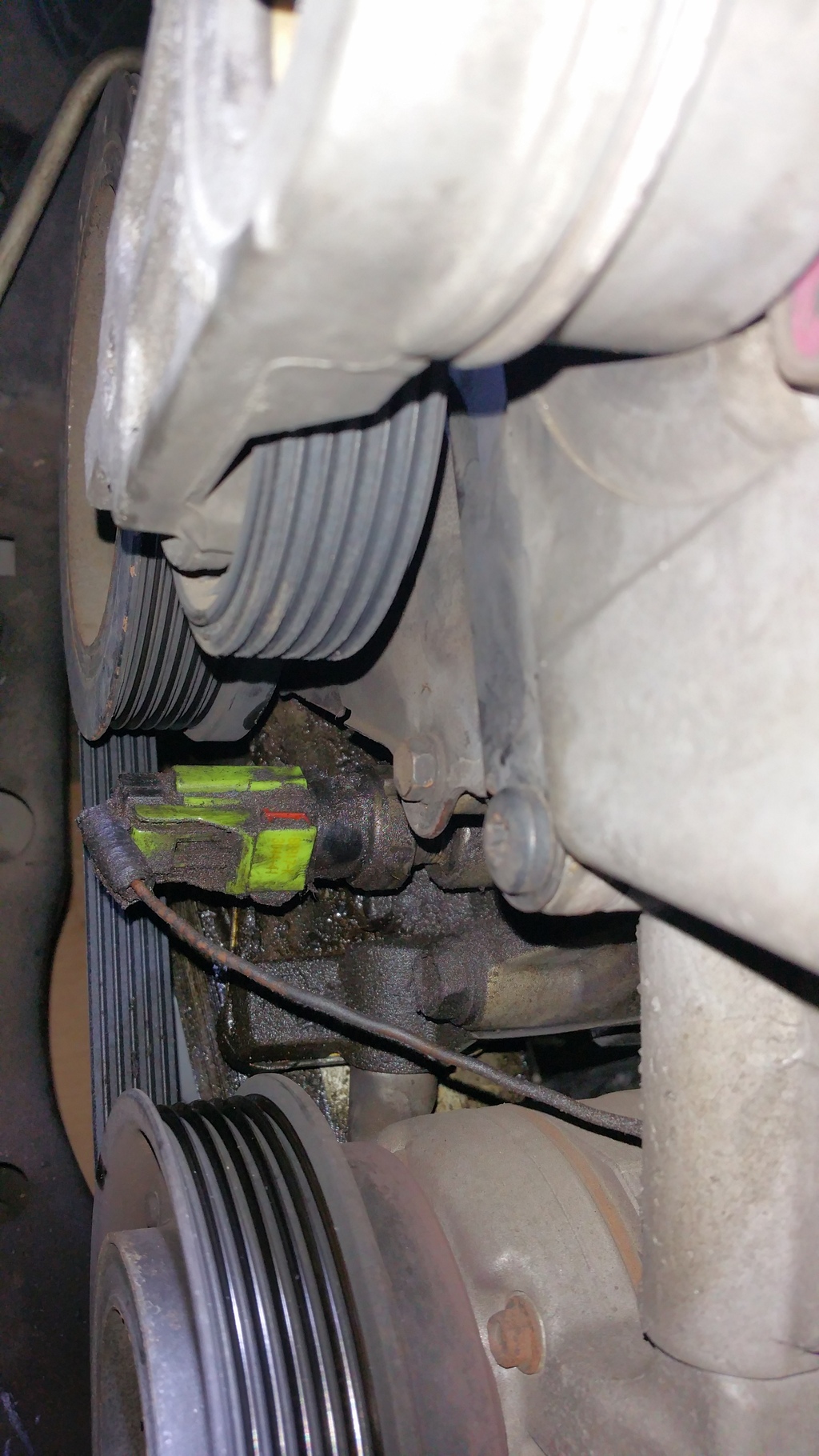

From the top side, there is some sort of sensor (haven't worked out which yet) that is covered in oil. I wiped some away to reveal a neon green connector. Anyone know which one this is?

The oil pressure light coming on as the engine stalls is probably a result of the engine stalling, rather than a cause. Once the engine has stopped, the light is on because there's no oil pressure in a stopped engine.
Take it to an auto parts store and have them check for codes in the computer. A stalling problem may generate some error codes. Places like Pep Boys and Auto Zone will often check for codes for free.
One of your photos shows a green fluid. That's almost certainly anti-freeze although it probably should be yellow in that car. The car may have had some improper maintenance in the past.

I've taken it to Goodyear to have the codes read, there were two: a tranny code (guy said could most likely be TCM) and a fuel/exhaust code. I don't remember them exactly but I've since (a week ago) purchased my own code reader that will bluetooth to my phone so that I can monitor it will driving. Once it comes in the mail, I will post the results. I'm not that experienced but the car shifts fine and I feel the tranny code could have more than likely be a symptom and not the issue. The fuel/exhaust code that it threw I'm itchin to check out and see if I can replicate that code myself.
You are right, the car definitely was not maintained properly (some military kid that trashed it and obviously spent more on audio and rims/grill than proper maintenance.) I just hope it isn't too far gone. That greenish liquid is definitely a coolant mixing with the oil that is also leaking onto the filter and so on, I just gotta figure out where.

The oil light problem may be a symptom of a bad sender or it could be an indication of a major engine problem. The cheapest and best approach is to replace the sender, making sure the passage leading to it is clean. If that solves the problem, then great. If not, if could be something much more serious like a weak oil pump or worn bearings.

Thank you so much for your help Dennis. I finally determined that the oil pressure sender is leaking oil which is what that neon green connector is attached to. Once I get the time to replace I will and update this thread on the status. Still got to find where the coolant is leaking from.
A quick question, even though the service manual does not mention needing to remove the belt, should I cover with a cloth so that oil and debris does no spill on to it?
