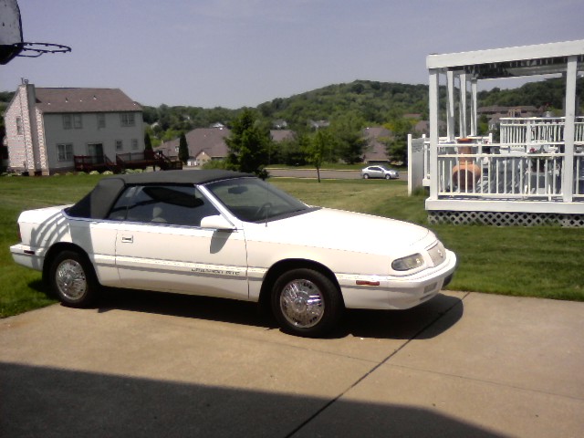

Hi, I'm new to this forum and just bought my 1st Chrysler, a 1995 Lebaron GTC V6, in AMAZING condition with 104,000 miles on it.

Oh, and I do love my new to me chrysler. It has so much more power than my Honda civic, and handles better to. And I Love the drop top.
