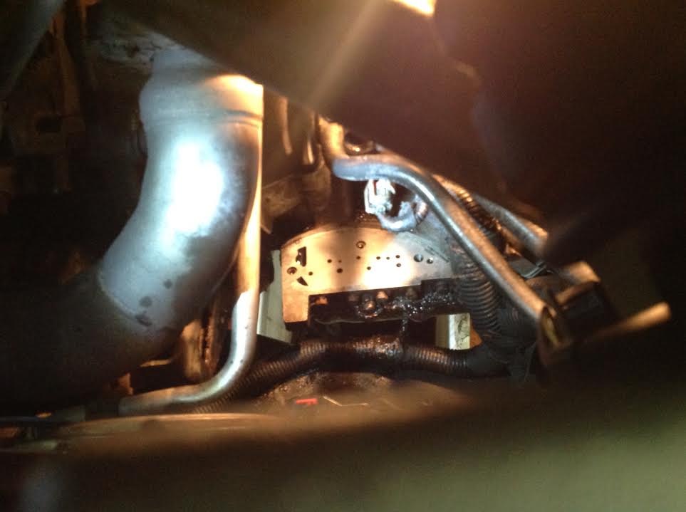

Hi,
Installing the new module on the Pacifica.
However there seems to be no thread in the housing for the bolt on the far right. As far as I can remember, it screwed out just like the other two.
There appears to be an threaded insert in the other two. If there was on in the third, I can't imagine how it came out or where it went.
Help!
Griff.
Old Jul 14, 2015 | 10:50 AM
That should be a tapped hole, just like the others. If there are "threaded inserts" in there, somebody put them there, perhaps because he stripped out the threads of the housing.
If the third hole is also stripped out, you're going to put a heli-coil insert in there to fix the threads. When drilling and tapping there, be extremely careful to not let any cuttings get down into the transmission.
Old Jul 16, 2015 | 01:12 PM
Griff's Avatar
Joined: Jun 2015
Posts: 13
Thanks.
Figured it out.
The hole for the right bolt is not the third lager hole, it's the small one next to it....
