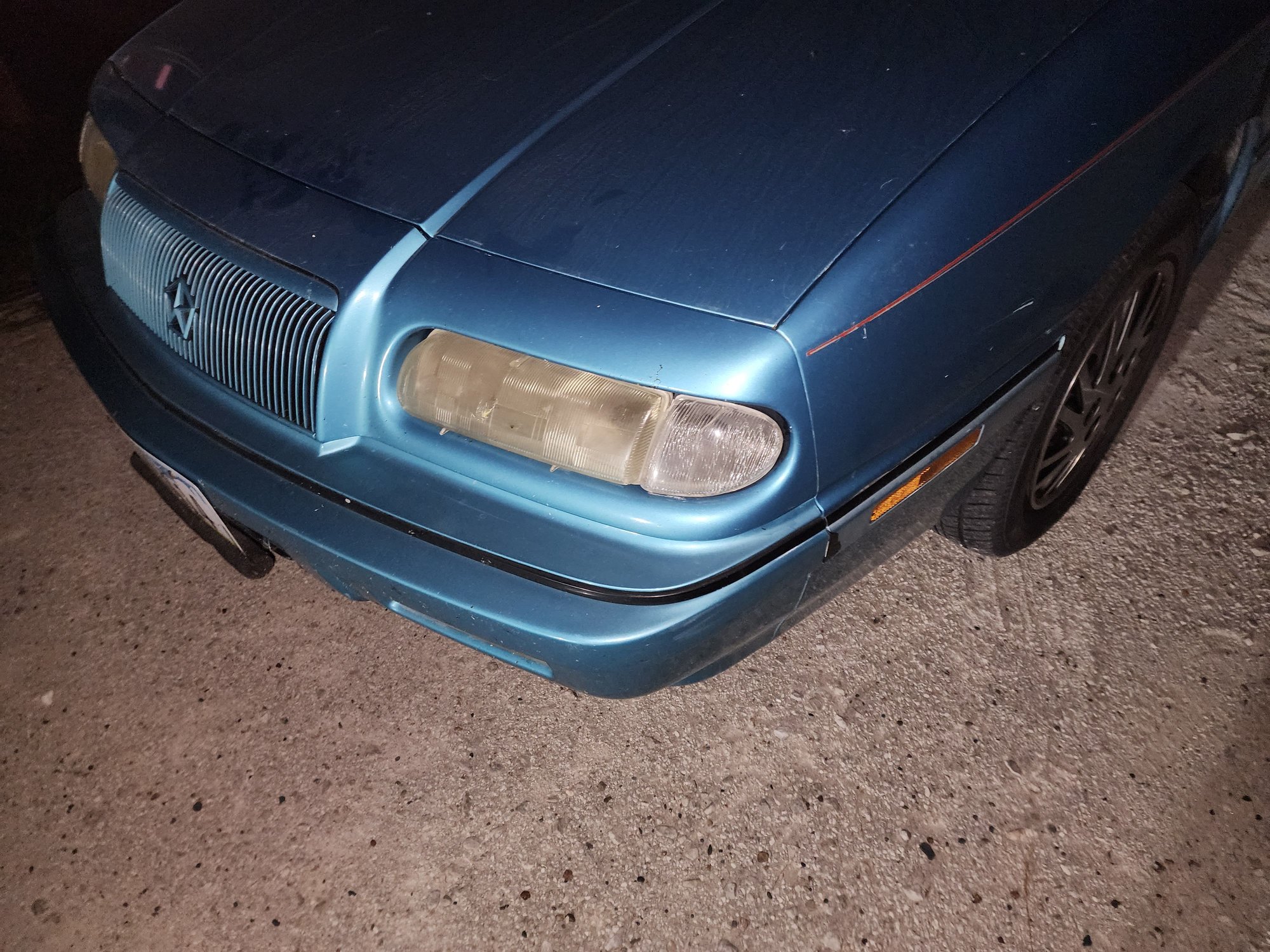

I am new here and hoping someone can help. I am trying to find new headlights for 93 Lebaron Convertible because mine are very yellowed and dull. Hard to see far in the dark. . Love the car and plan to keep it a long time. Everything I find is for Sedans only and not the convertible. If anyone has suggestions on where to find these or good way to clear them up I would be very grateful. Thanks, Dave

I have used the Cerakote headlight cleaner and was very pleased with the result which has held up for over a year. Smoothed out the lenses and got rid of the yellow. The wet sanding part was not difficult at all using the included handle.
The kit is under $20 at Walmart and has cleaner wipes, 2 grades of sandpaper (color-coded), and a clearcoat wipe for the final touch. Gloves are included. I suggest a spray bottle for the wet sanding part.
