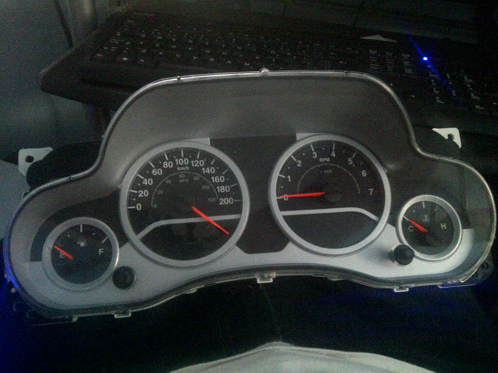

Hi I'm a new member from Canada. I also have a question that's been haunting me. Found a speedo but can't match it to any vehicle. Here's a pic can anyone help or give an accurate guess. It says Chrysler on back and the serial numbers lead to nothing. Thanks in advance.

what is the part number on the back

Looks like it's from a Jeep Wrangler around 2009 model. As far as late model clusters, these and PT Cruisers have to be the most common I see problems with. This type being the worst offender...they lock up quite frequently. Do the world a favor and don't list this on Ebay because it's probably a bad one.

Thanks TNtech, I think you may be right. Part number on back is CR-0036-215-K0-CB or 05172653 AB. Not sure which would be the part number. Just cleaning out the garage I dont think I'll list it but I'd hate to just scrap it.
Also should the needle on the speed gauge be positioned that way? It's not loose.
