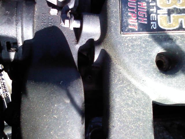

FYI: I bought mine with "overheating problems" turned out it was the radiator cap and their was air in the radiator system (their is bleeder scre on top of the intake).
Old Apr 23, 2013 | 11:24 PM
that's not a 300m engine they are only 3.5 and no bleeder screw on them .
Old Apr 29, 2013 | 03:53 PM
l911's Avatar
Joined: Apr 2013
Posts: 13
Default Thats odd....
HHmmmm....
