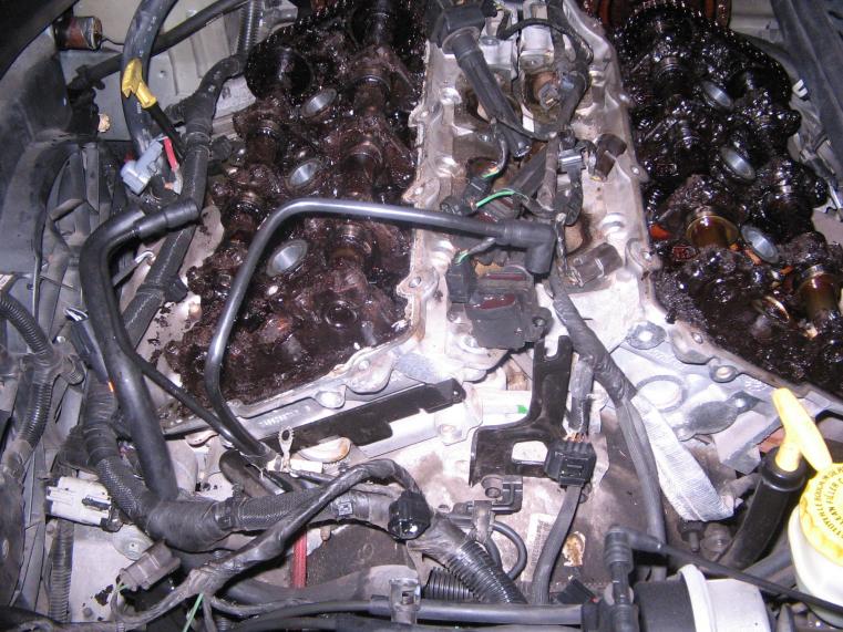

Attached Thumbnails head gasket,valve job,timing chain-img_0319.jpg   head gasket,valve job,timing chain-img_0302.jpg

two more
Attached Thumbnails head gasket,valve job,timing chain-img_0321.jpg   head gasket,valve job,timing chain-img_0305.jpg

dont wast your time any more unless u want to rebuild the whole motor u slugged up the engine

Posts: 19
Thanks for the advise of not wasting more time, I thought about it when I saw the sludge, I am going to have to remove one piston just to check how it looks in there and I might just do a on the spot rebuild just change the rings and rod bearings,, I know I am taking a gamble here but the truth is that I just bought the car about a month ago for about twelve $ and though it was a good deal to put some time and money on it. any more advise about the sludge about what other problems to look for would be appreciated
