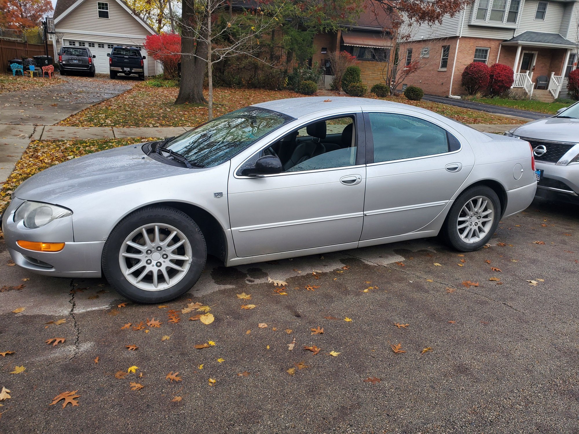

Just picked up a new to me 04 300m with 97k on the clock and clean inside out. Very cheap in price bit with low cost came a big problem. Car starts fine no motor issue trans seems to shift into gear with no jerking.
Here is the real big problem PO said it needed a new front sub frame the driver wheel is pretty much rubbing and the axle is snapped.

Thanks for the response. I checked it out and it seems, the lower drive side control arm broke off from the actual mount bracket that is welded to the frame. The frame still looks good from below some surface rust nothing really sticking out. Looks as if the actual bracket that holds the control arm to the frame snapped. Is that a peice that can be welded back on or a new sub is needed?
Pics below.
