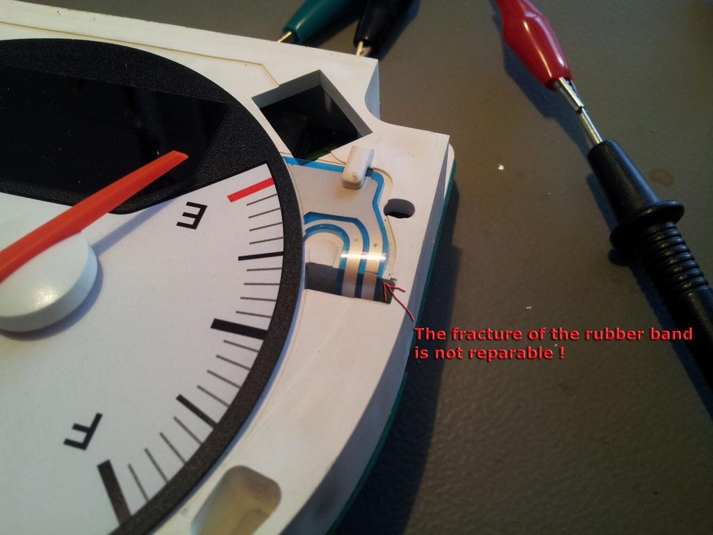

Well, now that you mentioned my ELD5 inverter that seamlessly repair illumination not only for Sebring 07-09 but also Avenger and Caliber (which doesn't have a "clock light").
It worth saying that the price for an end user might be higher than $85 (but more cheaper and reliable than a new Instrument Cluster) if you choose to sent your instrument cluster to be repaired to one of our US dealer/repair facility Chrysler Sebring | Dodge Caliber | Dodge Avenger Instrument Cluster Light - Fix, Repair Kit: Dealer List but you get years of warranty on repair operation, same as OEM dimming intensity function and no additional wires trough your car.
Of course everyone is getting what its paying for
I have many user who buy ELD5 inverter now, who previously tried this "clock light" and their dashboard looks like a mess ! Because de-soldering of the black socket lead to unwanted vibrations hence fraction of the flexible rubber band !

Here's a user who at least fixed the black socket with glue gun after renouncing to "clock light" and installed ELD5.
So DON'T LEAVE THE BLACK CONNECTOR DANGLING IN THE AIR even you don't want to use my repair procedure which doesn't tampering the black connector at all ! Chrysler Sebring | Dodge Caliber | Dodge Avenger Instrument Cluster Light - Fix, Repair Kit
