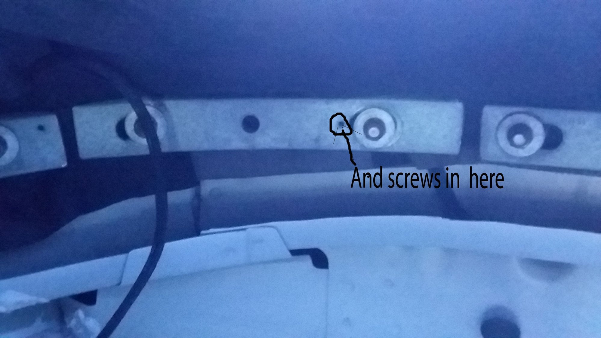

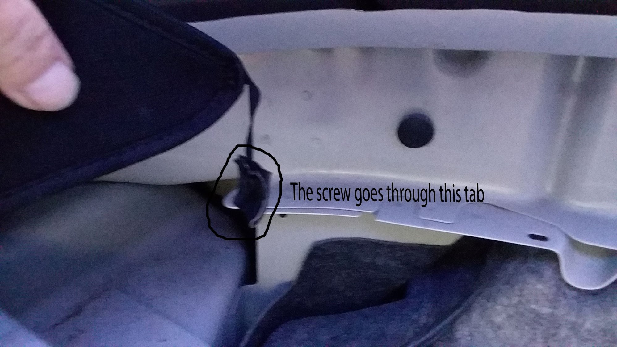

Sorry to take so long, but here are some pictures. I hope they will show what I'm asking about.

As near as I can tell, the parts book describes the part as follows:
22 06032650 2 C 27 SCREW AND WASHER, Tapping,
.164-15x.50, Headliner To Tack Strip Attaching
In that description, 06032650 is the part number.
I think that .164-15x 50 is the size of the screw, but I'm not sure exactly what those numbers mean. My guess would be the .164 is the diameter (#6?), the 15 is threads per inch and the .50 is a half inch long. Just a guess. Apparently it's a screw with a washer attached. You could try ordering the part by part number from dealership or you could buy a #6 screw, half inch long from a hardware store and see if it fits. Probably will be close enough. You shouldn't need a self-tapping screw since the first screw should have tapped the hole. Don't forget the washer.

Reporting back in hopes that it helps someone else down the road. Dcotter nailed it about the diameter and thread pitch. Turned out to be a #8 x 1/2 sheet metal screw and washer.
