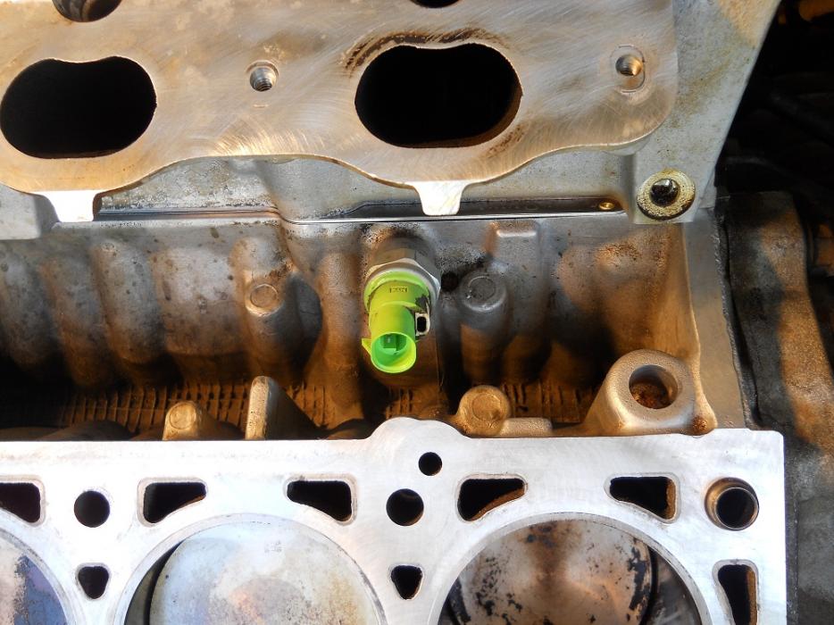

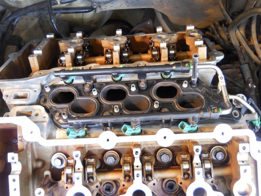

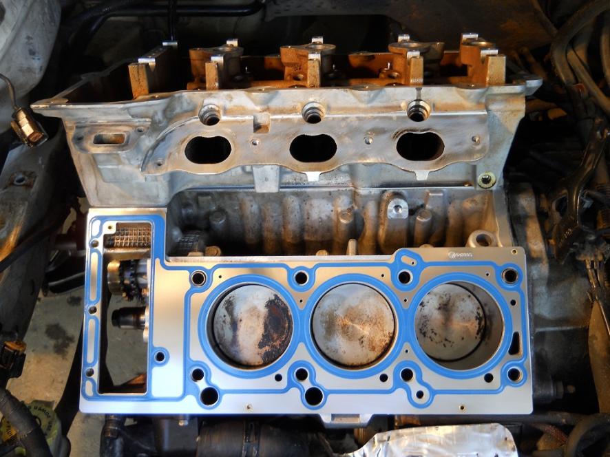

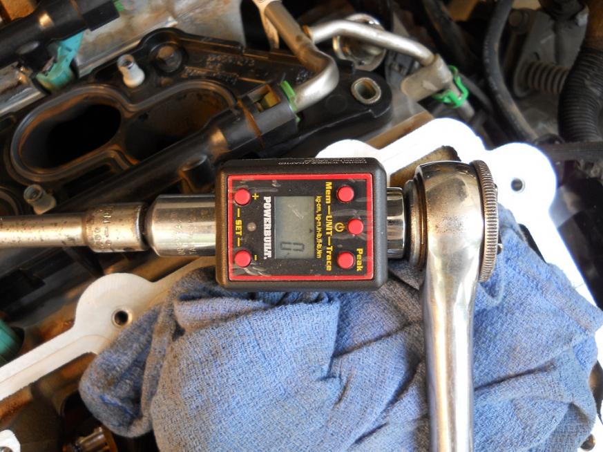

Here's an update on the progress...Heads are installed, lower intake installed, fuel rail installed, and exhaust manifolds installed..here are some pics..Wanted to mention to everyone...donted forget to install the knock sensor located on the back head that's installed underneath the lower intake...and also I picked up a digital torque adapter made by Powerbuilt, it was extremely handy...check it out!

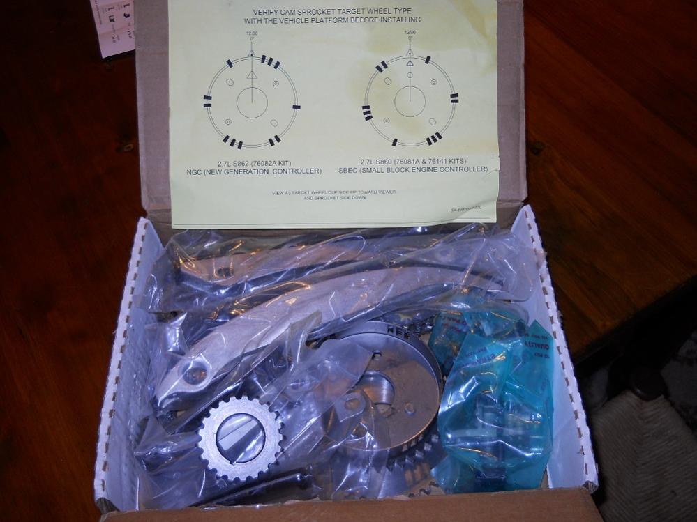

DC, Thanks for the info! Got my kit in today....here's a pic....now to get the crankshaft sprocket off and new one on without moving anything!!

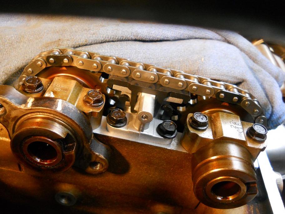

Hey DC, I have a question on the cams and the timing marks..I didn't really pay a much attention to the short cam chains as much as the primary. Here's a question about the short chains..standing in front of the engine..cams on the left next to the firewall only have dots which I lined up with the colored links in the 12 oclock position 90 degrees from the head surface. But the right cam sprockets on the radiator side has dots and triangles...if you put the colored link on the dot it is not in the 12 oclock p. but if you line up the triangles its good to go...just wanted to ask...I can take some pics if necessary...

From the service manual:
"Count chain pins from the mark on the intake camshaft towards the exhaust camshaft. Engine is timed correctly when there are 12 chain pins between the timing marks on the intake camshaft and exhaust camshaft."
From what I see on your picture, you have it right.
With the cams in this position, the crankshaft should be at TDC for #1 cylinder on the exhaust stroke.

Thanks DC!, Yeah I was having a some trouble deciding about the triangle or dot on the camshafts and realized that the large cam sprocket on the radiator side has a triangle on it, so I determined that the triangles on the Intake and exhaust cams on that side was what I needed to line up on.. anyway I took the old crankshaft pulley off and put the new one on this afternoon, so should be able to get the primary chain on tomorrow.
