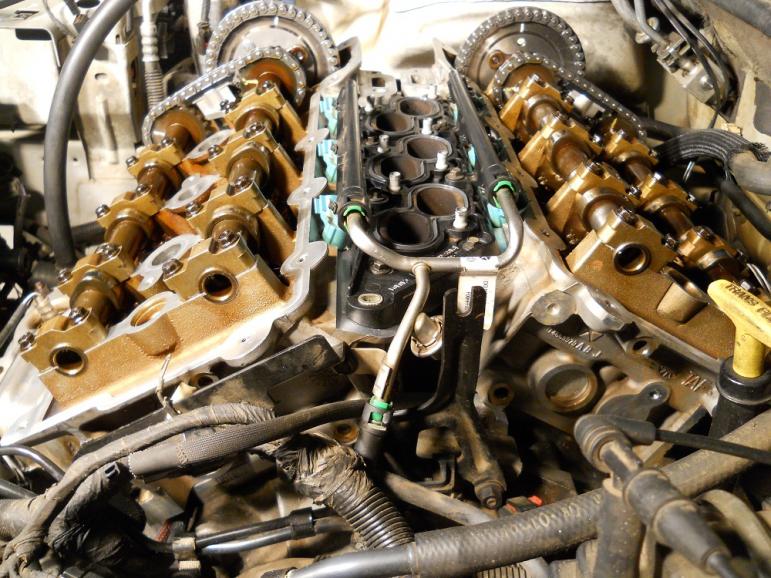

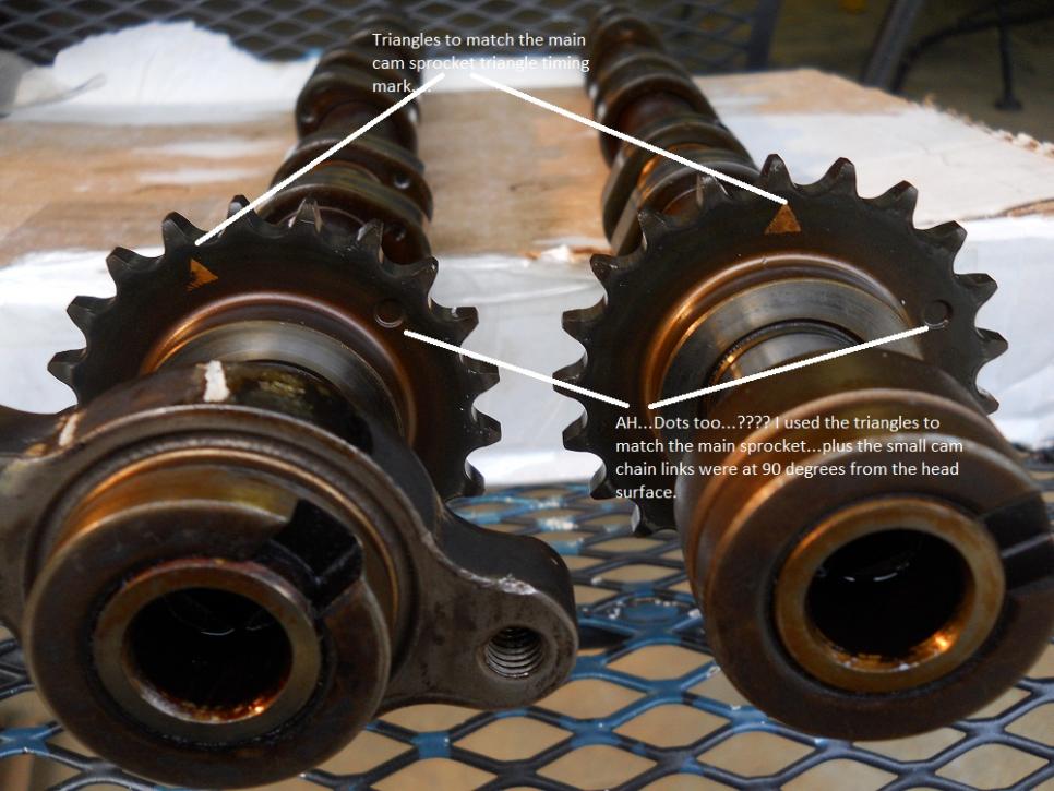

DC,I was careful! It's not easy! the crank still budged alittle say 1/8 to 1/4 inch but I was quick to move it right back to the marks again, that crank sprocket is something else! Anyway the timing....please help! I took a pic of the what things look like so you can first hand...all 4 cams are on the marks and they have a 12 link spread..and the marks on the primary chain are lined up on the sprockets and crank but on the rear cam hub would have to be turned CW to line up not CCW like the book says and on the front cam it's ok it would need to be turned CCW for line up...I'm stumped not to mention all the white marks everywhere...just out of curiosity I put the old rear sprocket back on just to see if it would match anything....But hey no guessing it's right on this part!! maybe you can see the problem......Oh almost forgot the front cams have dots and triangles and the large cam sprocket has a triangle like the Haynes manual drawing so I deducted that the triangles were the marks I needed to use...I could be wrong...??? the pic in the Haynes manual for TDC shows just dots on that drawing...Dots or Triangles???

Here's the procedure from the Shop manual:
Align crankshaft sprocket timing mark to the mark on the oil pump housing.
(Lubricate timing chain and guides with engine oil before installation.)
Place the left [front bank] primary chain sprocket onto the chain so that the timing mark is located in-between the two plated timing links.
Lower the primary chain with the left side sprocket through the left [front] cylinder head opening.
Note: the camshaft sprockets can be allowed to float on the camshaft during installation.
Loosely position left [front] side camshaft sprocket over camshaft hub.
Align timing (plated) link to the camshaft sprocket timing mark.
Position primary chain onto water pump drive sprocket.
Align right [rear] camshaft sprocket timing mark to the timing (plated) link on the timing chain and loosely position over camshaft hub.
Verify that all chain timing (plated) links are properly aligned to the timing marks on all sprockets.
Now, with respect to your picture, it is taken from the left side of the car and doesn't show the timing marks and plated links. There are four plated links on the primary timing chain. Two of them are together. Those two links should wind up on either side of the timing mark on the front sprocket at the 12 o'clock position. The plated link at the crankshaft sprocket should be should be sitting exactly at the timing mark which should be exactly at the corresponding mark on the oil pump housing. This should be at approximately 3:30 o'clock at the crank. The fourth plated link should be right on the timing mark on the rear sprocket at the 12:00 oclock position.
These timing marks and plated links should be visible from the right side of the car. In the shop manual, the timing mark on the front sprocket is depicted as a triangle, the timing mark on the rear sprocket is shown as a dot. The timing mark on the crank sprocket appears to be a semicircular notch while the mark on the oil pump housing shows as a triangle.
Hope that helps.

When I get in tonight I'll take a pic from the front so yu can see the timing marks...by the way the marks line up no problem...It's that part in the manual that tells you to insert the 3/8 rachet and turn the cam hubs CCW slightly to line up the bolt holes..my problem is the rear cam would have to be turned CW to line up, but the front cam is ok..I guess that's why I ended up taking a pic from the back side...
DC...UPDATE for you:::Pics of timing...However I have another question too....now that everything is complete and the tensioner is released, can I rotate the crankshaft with my rachet to make sure everything is ok?? the next step in the Haynes manual is to install the timing cover....Hey thanks a million for all your help! Oh almost forgot for everyone the front cams have dots and triangles so pay close attention to what your chain is lined up on for the timing..

As long as the cams are tied to the crank via the chains, it's ok to rotate the engine. If your timing procedure was correct, everything should be fine. If not, then you're going to bend some valves whether you rotate by hand or starter motor.
If you're in doubt, put some wooden dowels in the spark plug holes so you can watch the pistons' movement, and turn the engine very slowly, a few degrees at a time while observing the cams operate the valves. If you see a cam open a valve while the piston is approaching the top of its stroke, stop and find out what is going on.
