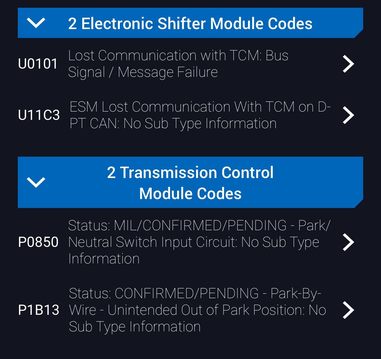

Default Pulled codes
put a scanner on it and see if you have any codes in the pcm like a brake lite switch issue
These are the codes, they are aiming towards the TCM. I’m trying to see if someone else has ran into this issue and knows a cheaper fix.
Old Jan 15, 2025 | 07:33 PM
Could be a tcm or a parking praw sensor
