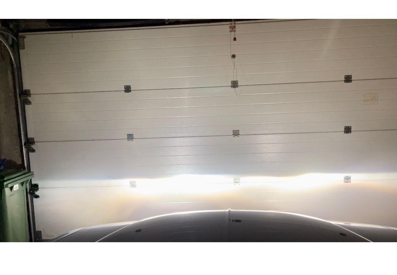

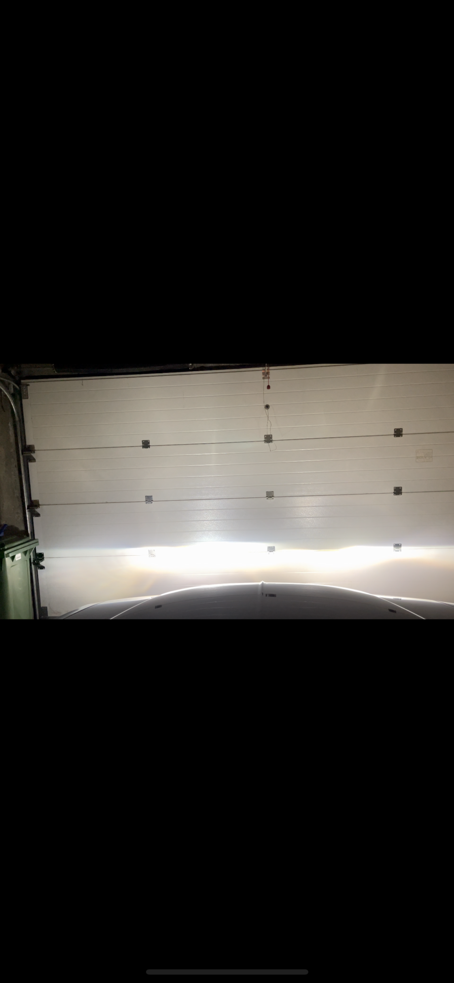

Hi guys. I have problem with my 300c 2006. Few days ago my ballast for xenon goes away. And I purchased new one. Mechanical change it. And everything seems fine. But when I parked in garage and watching lights. I heard some knocking.
when I turn lights, xenon go up and down, left lamp go up. And stay on right location.While left (changed) go up stay and then down and and make some klicking. Few cm lower than left. I wonder how can I reset headlamps, or leveling. Or did someone know how fix it Balast is same like before. Valeo lad5g
Starting
Moment in leveling
After knocking right bulb go down little bit

Ivan - I have no particular insight to this problem but you may try the old stand by: disconnect 1 battery terminal and hold it to the opposite terminal for 10 seconds. This clears the various memories and allows them to reset on start up.
That failing, could your mechanic have screwed something up when installing the new ballast ?

Tnx for replay. Tomorrow I will try restart.
I ask him did he unscrew something. But he say that he just changed Balast. I lived in Croatia, and only few people know repair chrysler cars -.-
i figured, maybe car remember location of Balast in moment of shutting down. And now when I changed new one he put it in old location. And trying level on old location. 🤷🏻‍♂️
