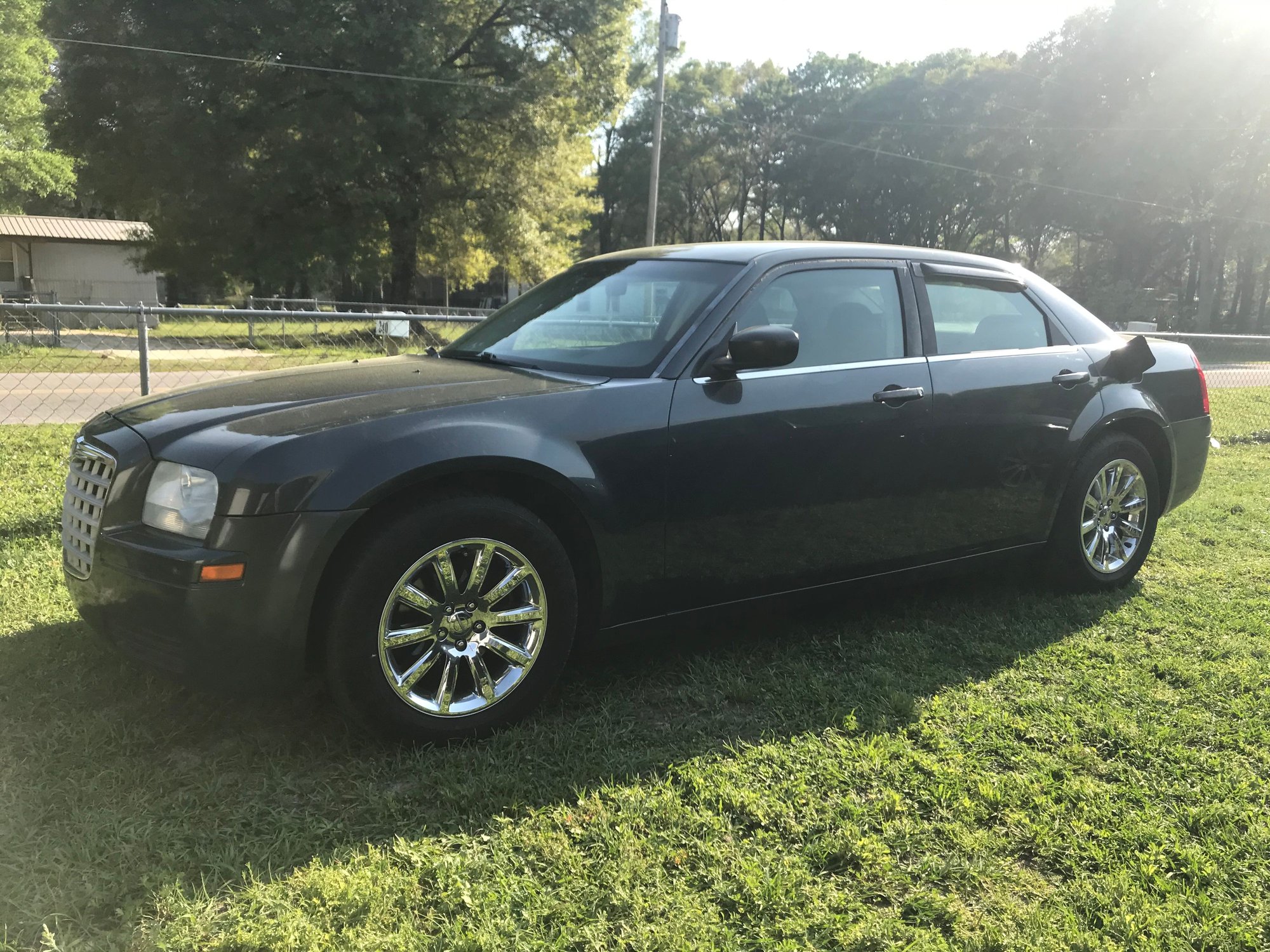

Hey guys! I bought a car this past Friday-without- checking the oil first. I know I know, rookie mistake. But after getting it home and parking it, I opened the cap to see like a milky substance in the top. I’ve tried to bring the car back to have it looked at but I’m pretty sure they will be of no help. With that being said I have prepared myself for the worst, I suspect it’s a blown head gasket. I know absolutely nothing about cars, but I am bound and determined to get this one fixed. What other things could cause oil to look milky? How much does new head gaskets cost? I should also mention that on the way home from the dealership, the car overheated. After a bunch of back and forth with the mechanic, he stated he had done a valve cover job and forgot to put the water back in the car. There was also apparently no oil in the car but after some inspection it was the wrong dipstick for the car. I have a new dipstick specifically for this car coming, and I have been given advice to change the oil. Should I start with that and go from there? I hope this post makes sense, I can clarify anything if need be!

Don't assume anything. Get the fluids straightened out and see what that reveals. Have the oil and coolant checked before you throw the old stuff out. See if there are products of combustion in the coolant. See it there is coolant in the oil. Do a compression check. These are relatively inexpensive checks that can determine if there's a head gasket problem. The car is 13 years old and who knows what kind of maintenance it has had. Transmission and brake fluids should also be checked.
Oh, and close the gas filler door.
