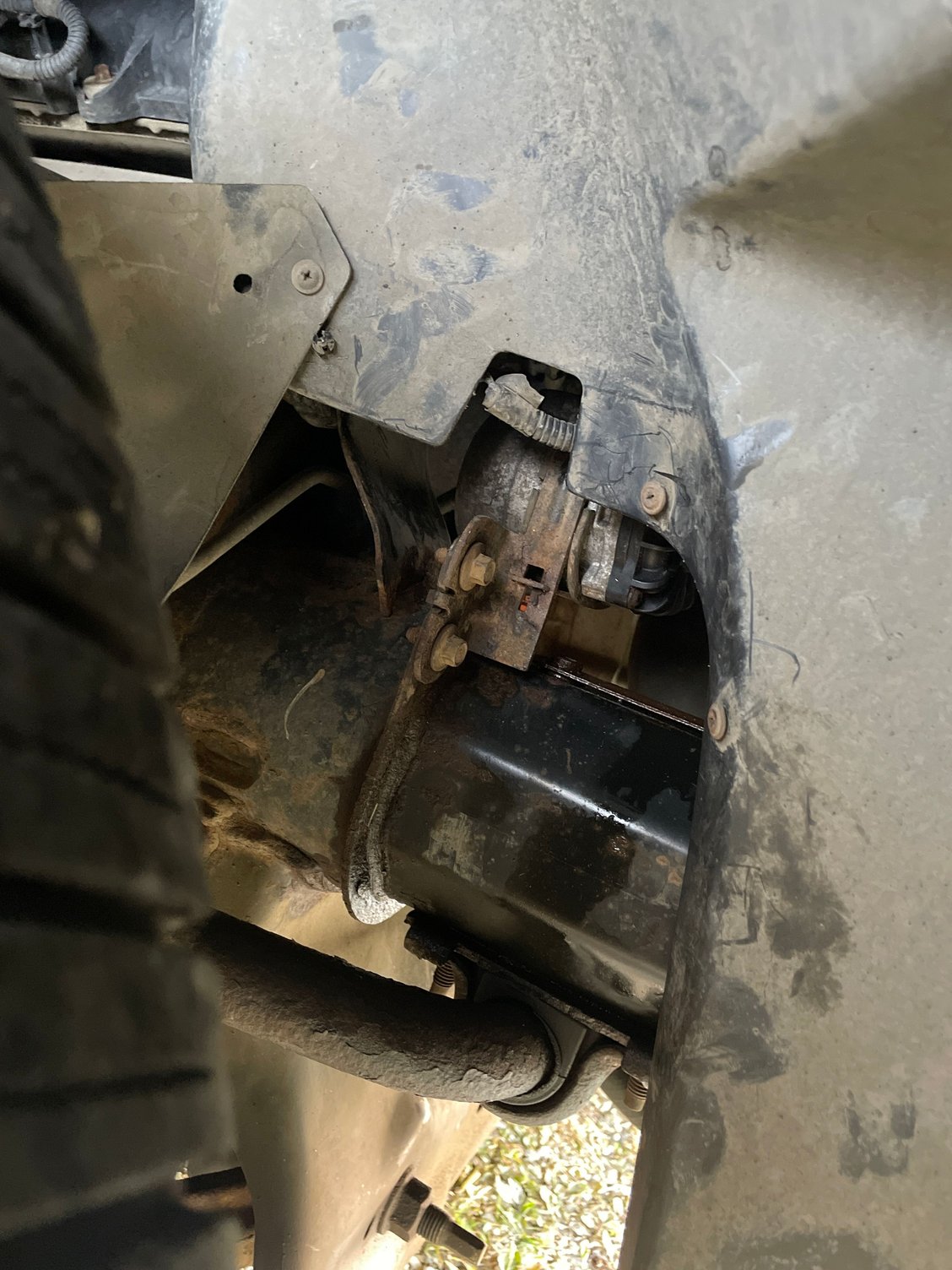

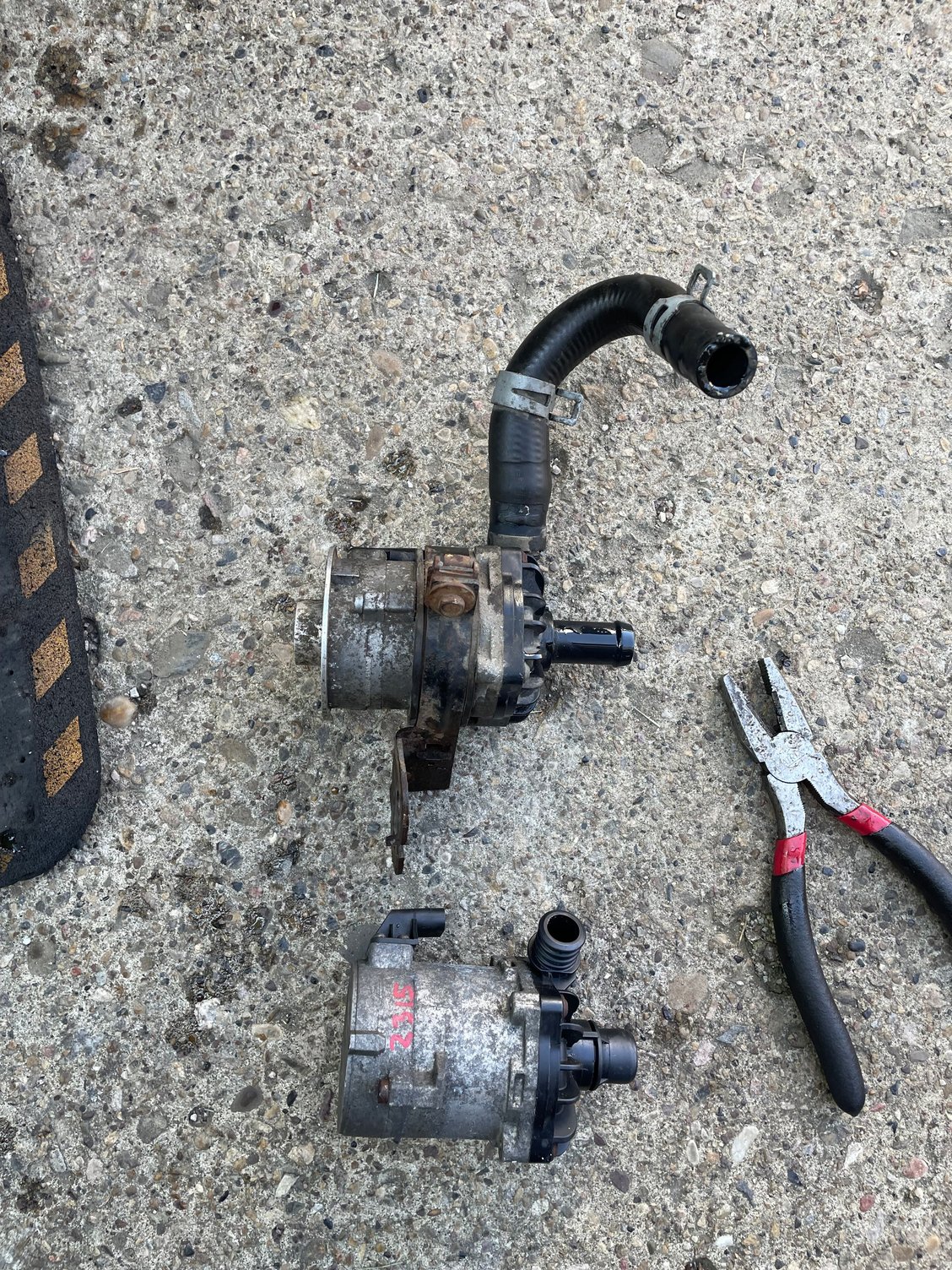

it’s most definitely the auxiliary water pump. Hardest thing was finding someone who could help me find a pump as it was discontinued and no aftermarket. But after 2 brutal winter I finally found a pump that work. (Thanks to google and hrs of searching) Off a BMW. Here the part number 17127850113.
I was able to find a used one for $125 bucks and the aspen heater finally works.
it’s also located right behind the driver side front wheel well.
Old Sep 14, 2025 | 03:11 PM
hiraeta's Avatar
Joined: Sep 2025
Default Sorry it’s the front passenger side wheel
The auxiliary pump is located behind the Front PASSENGER SIDE wheel well. Sorry correcting myself.
