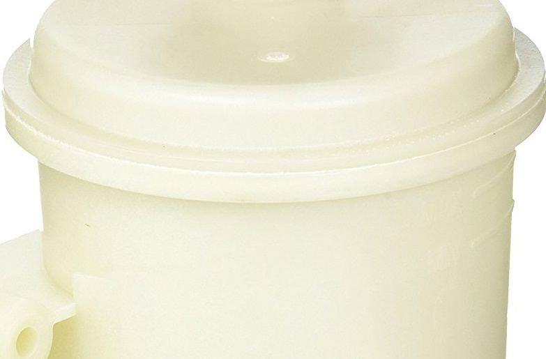

Okay, so I went out and looked at mine. The first picture is of my reservoir. Best image I could get due to angle. I can barely see a line about a quarter of an inch from the top which says "MIN". I can not see the "Max" line. So it must be close to the top. Second image is from Chrysler's website. I know it's not an actual image, but gives you an idea. Third and forth images are from Amazon. These give you the best look at the marks. The third one is as seen from front of vehicle and the forth would be if you could look at the back side of it. Hope these help.
On my truck. Red line indicates MIN line. Can't see max line.
Image from Chrysler's website.
Image from Amazon. Can barely see lines on right. This side faces front of vehicle.
Image from Amazon. This side faces rear of vehicle.

Nice pictoral help there C.C., the vans are similar but shorter with more circumference, but same principal of operation
