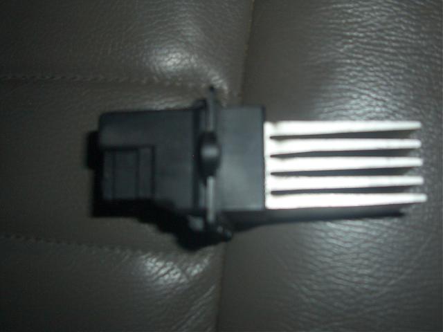

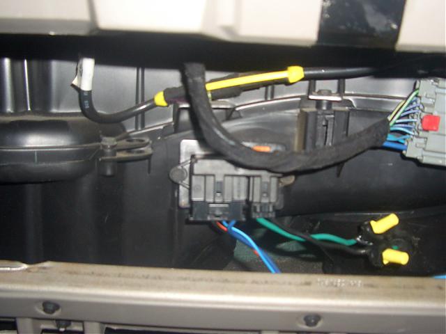

My problem was that the fan would not work at all. I read this a also cause by the Blower Control Module and replaced it this morning and everything is working again. The part has been upgrade and has a new part #, 5179985AA. Cost me $60 plus shipping. Here are a couple of pictures. Looking at where it is, behind glove compartment and the part it itself. This picture is the old one, the heatsink is different on the new one.
Remove the two screws and pull the module out. Unplug the two sets of wires and you will see this part (this is a Pacifica with AUTO TEMP. CONTROL), the part for those without it, looks much different. Probably disconnect the battery to be safe.
Jeff
