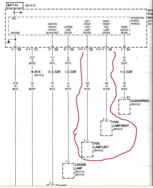

Some time ago during one of the rain storms my fog lights decided to just quit working. I removed and checked both bulbs, as well as the connectors. The bulbs are fine, but I have no power at the connectors. The dash light still illuminates when I pull the switch, but that’s it.
I did a bit of research and found there is no fuse or replay for the fog lights. That being said I’m kind of at a loss as to what is going on.
Just a side note: These are factory installed fog lights, not aftermarket.
Would anyone have any suggestions what the issue is and how I can fix it?

Holy toledo, you are correct, no fuses! Thought there must be a few fuses in there or a bi-metal thermal overload, but nope, just the mega Integrated Power Control Module with some wires going out to the Foggies. So the issue would seem to be either the switch (which seems to be doing something and prolly is working), the PCM (ouch) or the C5 connector. Please see attached PDF wire diagram. If all else fails, one could do something using the headlight wiring and possible an underhood relay and fuse...

The PDF won't open. Says I need special permission.
I have done just about every test one could imagine with exception to the TIPM. I don't happen to have a DRB3, and the dealer want's $180 an hour for diagnosis. I was, and am hoping it's something besides the TIPM, but I am starting to focus in that direction.
