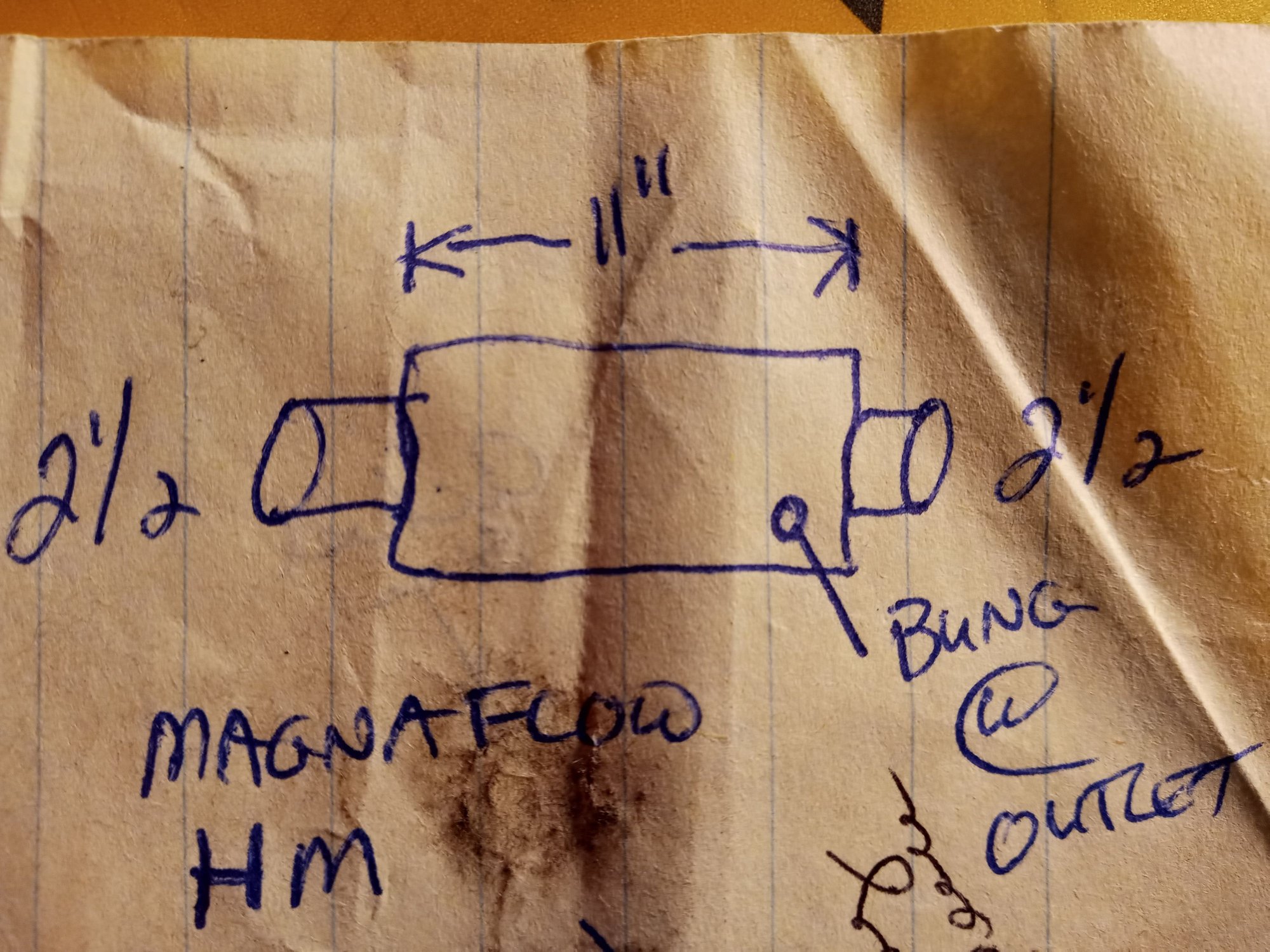

Hey Chrysler Tech,
I looking for a catalytic converter and muffler to order for my 05 Chrysler Pacifica 3.5 AWD Touring. My mechanic wants me to bring him one with the bung to the rear. (See diagram.) However, most I find online have the bung in the middle. Can you recommend a site to buy the correct catalytic converter and a muffler to match.
Thanks,
UberPacifica2005
