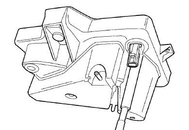

I looked at my 2005 - there are two vacuum lines at that location. It looks like you have one already hooked up, going to the cruise control - it goes into a check valve into a thinner line in your photo. The other line is supposed to connect to the vacuum reservoir, which is underneath the battery. The vacuum connection faces towards the center of the car closer to the front of the car - the battery would be sitting above the picture below, the right of the picture is toward the front of the car. Hopefully this helps you out!
P.S. - click the thumbnail, not the red link - it doesn't work. I tried to just paste the image into the post, rather than as an attachment, creating that link, and now I can't delete it.
Attached Thumbnails Emissions Hose? ID help-pacifica-vacuum-reservoir-schematic.jpg
