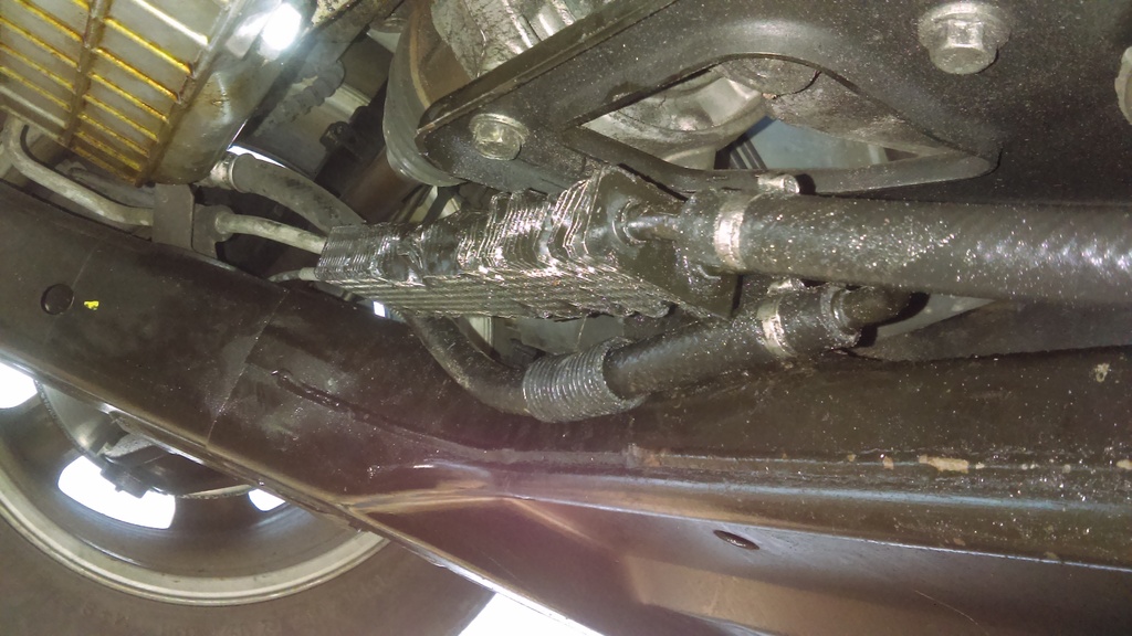

but mine looks all banged up and is leaking so i apparently need to replace it..
looks easy to do but is it?

not even close to being that easy

can't even get the hoses off! there's no screw and nothing to grab/pinch off to loosen the steel hose clamp... on top of that i cannot see anything to even get the cooler off.....
i bought a aftermarket one and it doesn't even look the same in size... the ****.

Those OEM hose clamps remind me of the inner tie rod clamps - they don't loosen. They are crimped during assembly and are not reuseable and get destroyed during removal. Anyway, stick a large screwdriver into the crimped opening and pry it back and forth to widen and loosen it. If it is like the inner tie rod boot clamp it will "unsnap" and come off. Use a conventional hose clamp to replace it. Good luck.
Old Mar 2, 2016 | 07:49 PM
Make it easier on yourself by cleaning under there with some engine cleaner and a hose before you start. Let it dry so it's not dripping on your face. Before you pull anything apart, hold the replacement part up there to make sure it will fit. If it won't fit, take it back and see if there's another one closer.
A wire cutter might make removal of the clamps easier.
