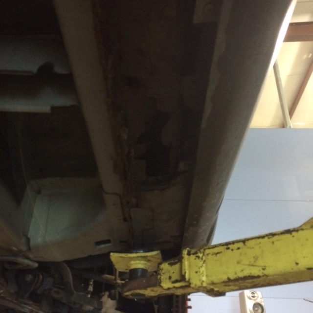

Had an '05 on the lift the other day. This is looking forward under right side. Notice the large hole that opens up into the rocker panel. Similar to my old GM vehicle that had consistent water in the right front floor.

I'm almost positive that underbody damage is not my issue, as my leaking happens even when (and actually most noticeable when) the car is sitting still. Such as, parked in a rainstorm overnight and the next morning the rear carpet would be soaked. Plus, I am under my Pacifica a few times/year at least, for oil changes and other stuff. I've never noticed any serious underbody corrosion or rust-through like that... so far.
