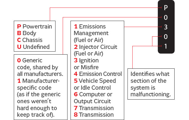

Fault codes are useful starting point, but they need to be interpreted correctly together with viewing live data and other test results.

- if it give all 4 sets of full information, in particular the 1 & 0 codes of Voyager CRD's
