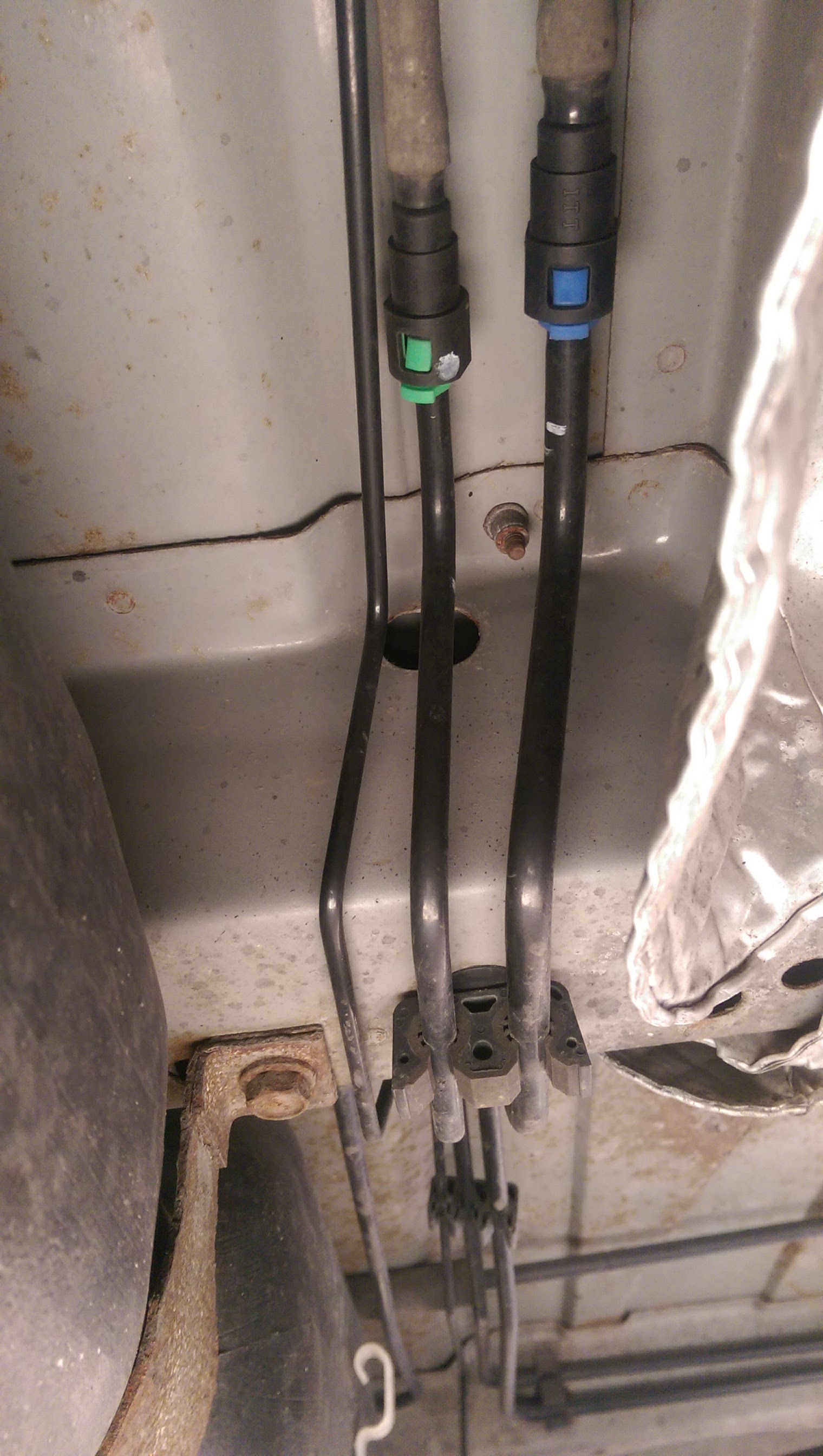

Sorry but not quite accurate there. This is the 2.8CRD 2004/2005 and it has the electric primer/lift pump and filter assembly to the rear, in front of the rear axle beside the fuel tank.
Here is the lift pump and filter assembly under the rear of the car:

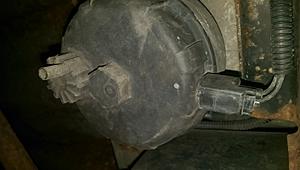

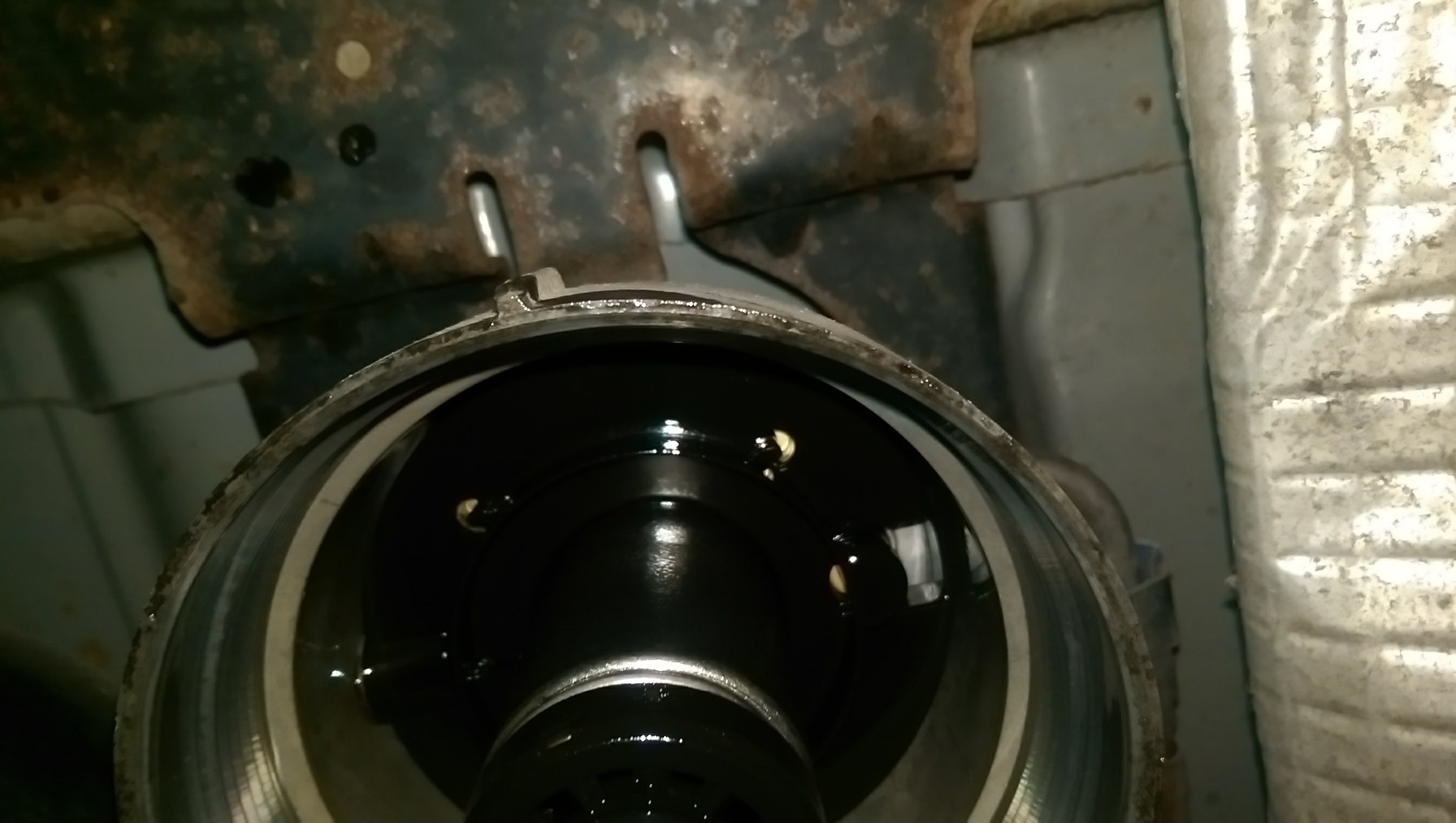

And after I've removed the plastic lower casing, and then removed the filter, this is the remainder of the pump.
O-Ring and plastic pump housing/casing all looked fine, no cracks or damage, so don't think this is where my issue is.

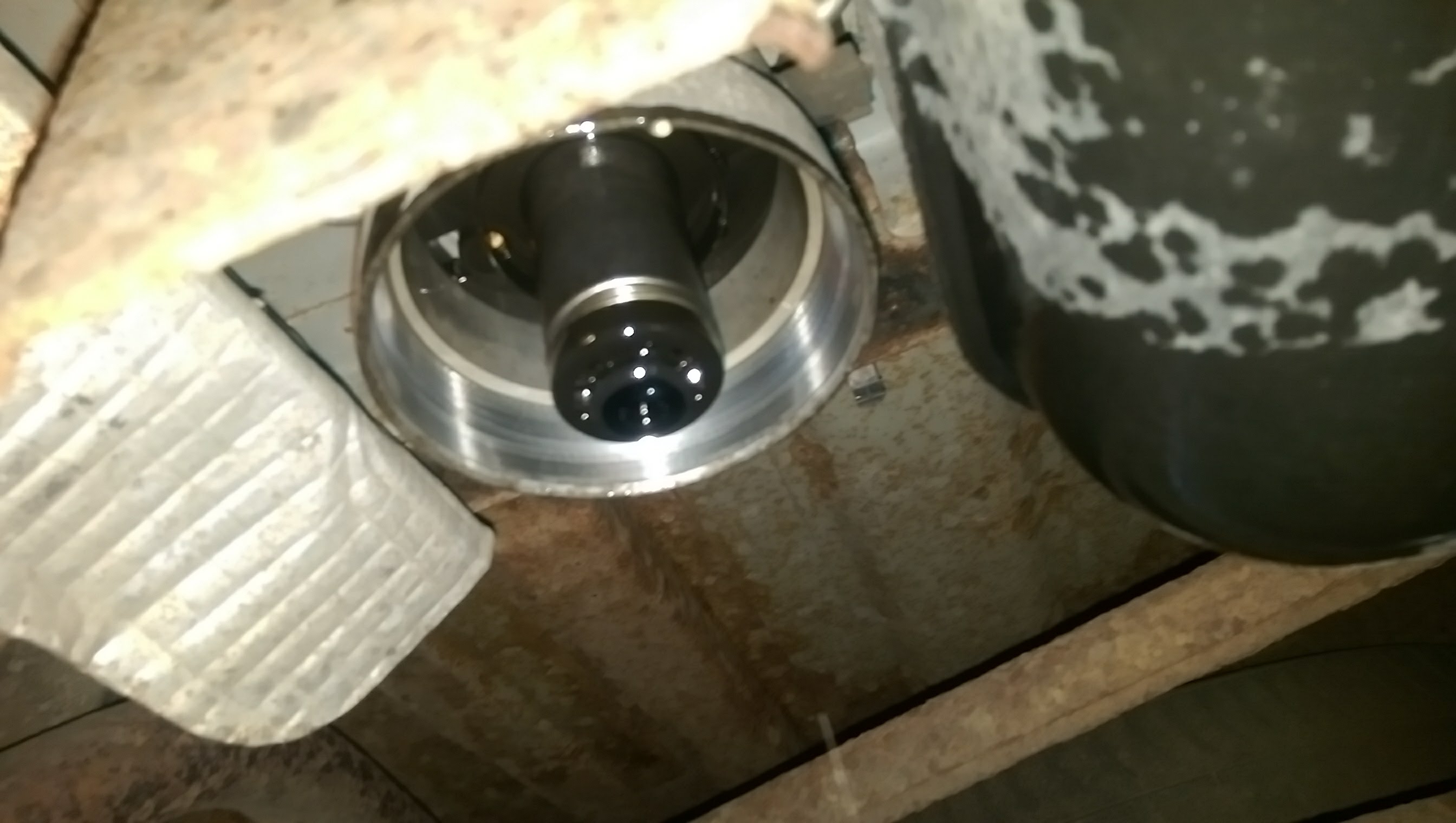

This is looking up at the pump inside the housing:
And the fuel lines heading to the front of the vehicle, look in good condition. In fact these and the tank look relatively new and in decent condition, anyone has an opinion on these fuel lines? I think they must have been replaced before I got the car.
