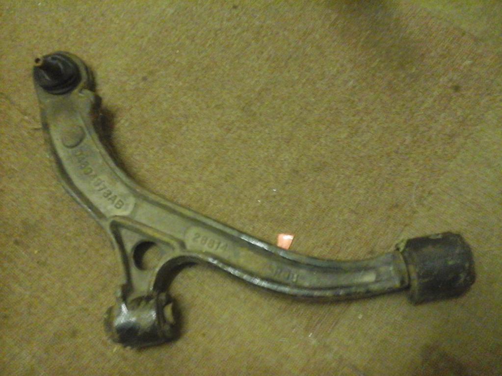

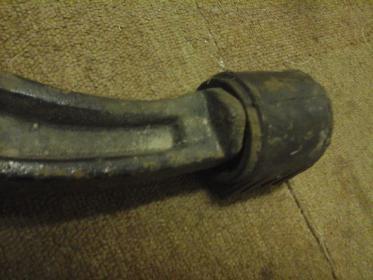

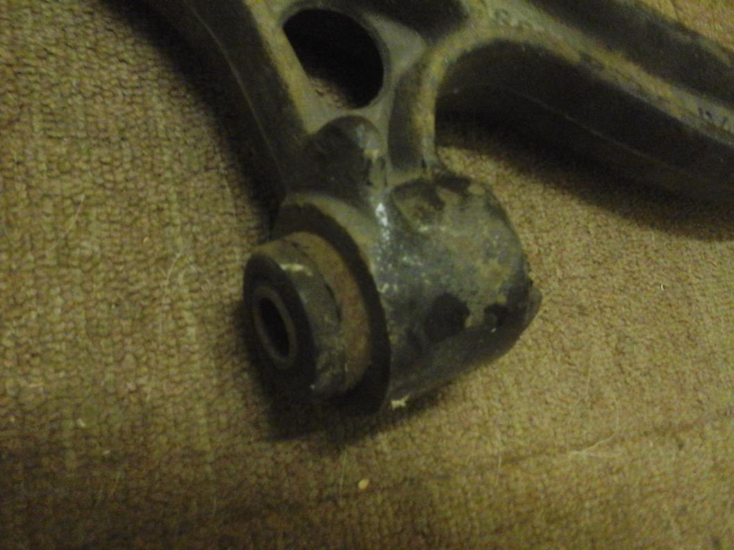

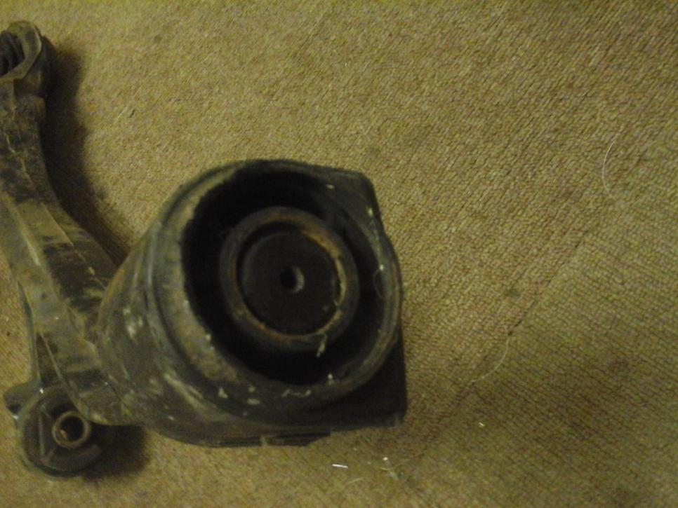

Not sure if your arm is same as my 2003 Voyager but here's picture of whole arm, front bush, rear bush and end on of rear bush.
Looks like its pressed on, so easy to take off with cutting disc, almost through bush, then final split with chisel.
But its a pressed on affair. Or if you hammer it on, take care bush is properly aligned and softer metal between hammer and bush.
Not a job for a ham fisted or temperamental person.
Good Luck and post your result...
