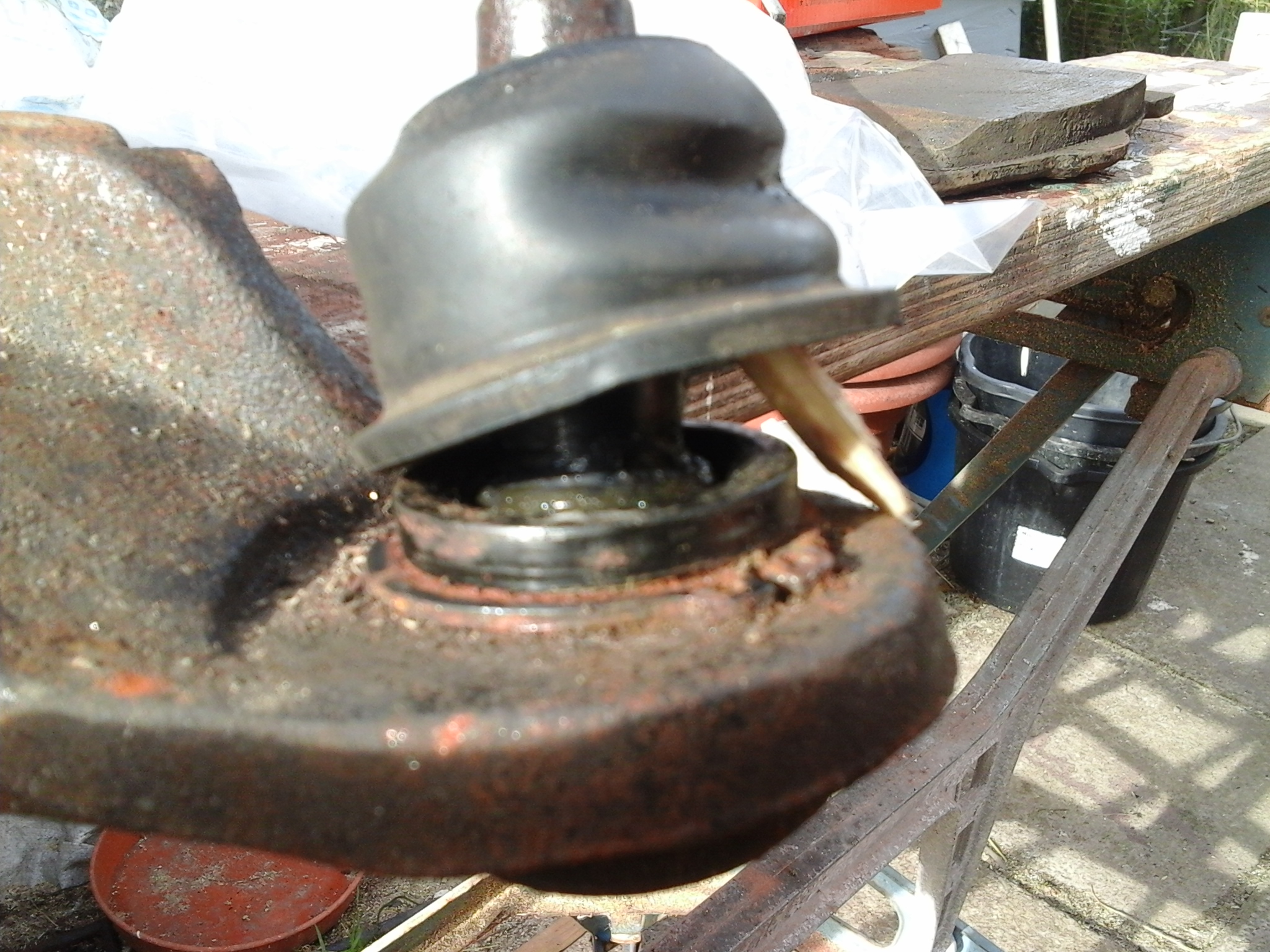

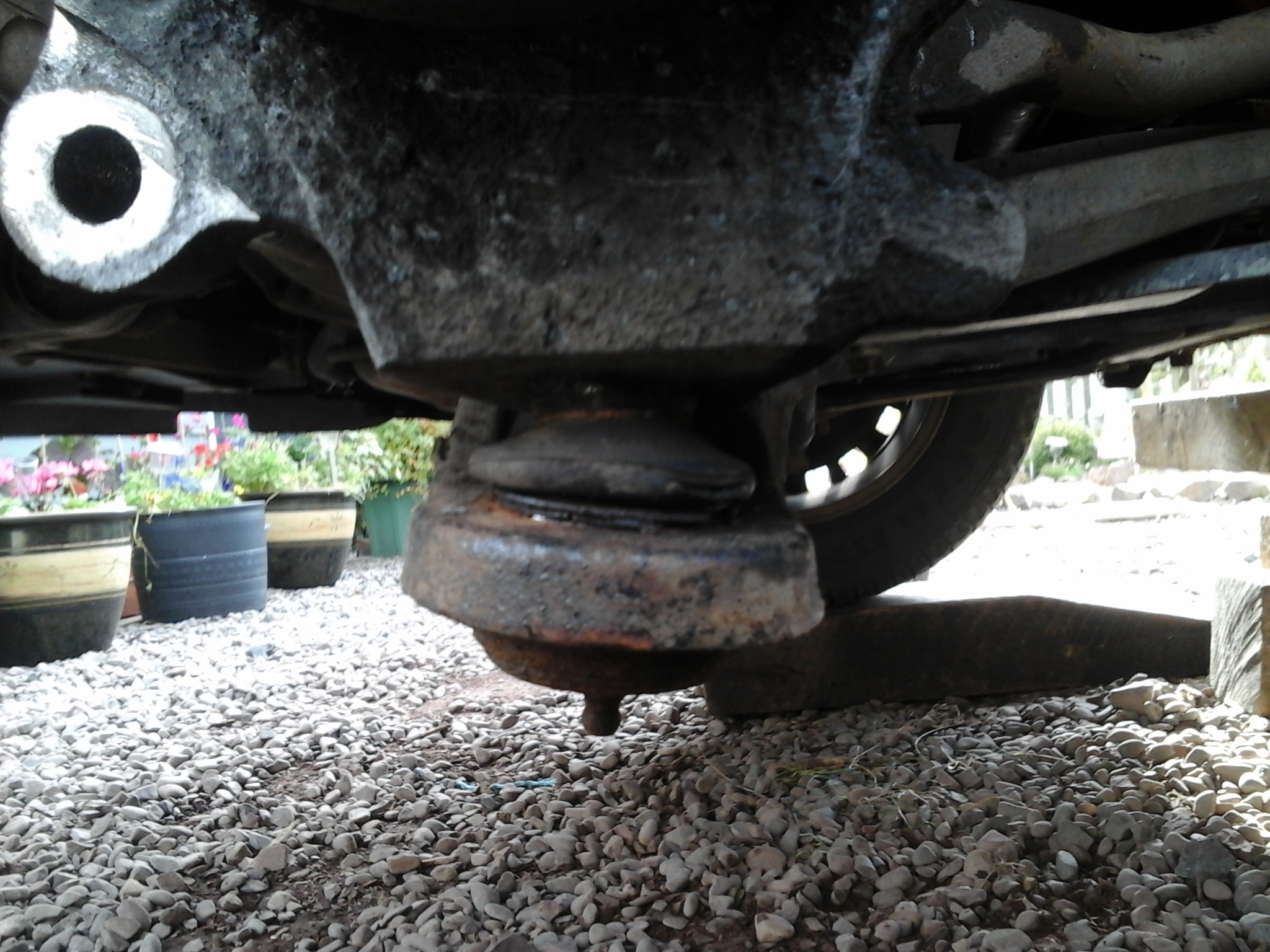

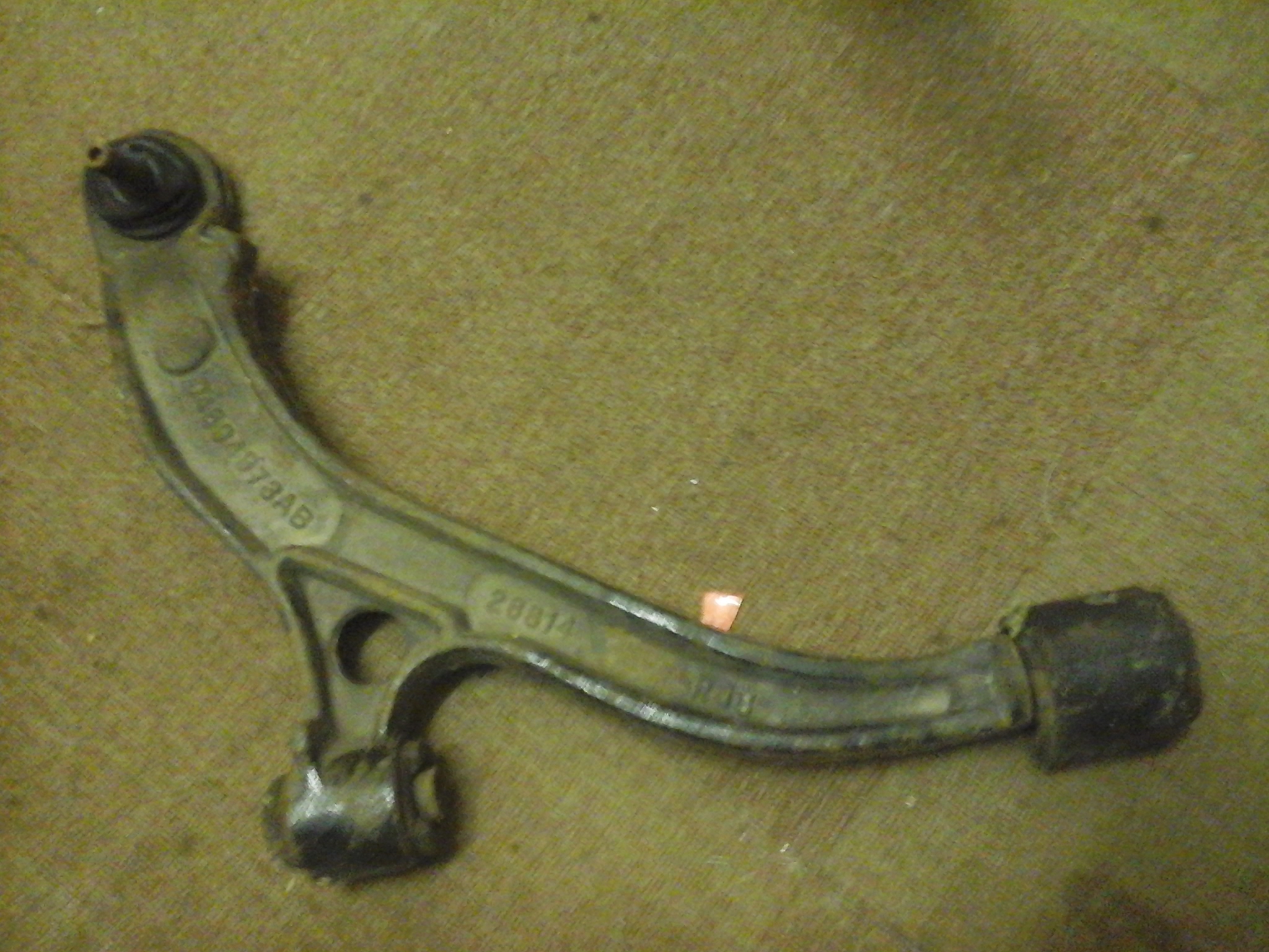

Front end alight no. Check flee bay for what it looks like. Does it look like this from my 2003 Voyager. Bushes are renewable. Ball joint pressed in & clipped. Workshop facilities required.

Considering it's got 152,000+ miles and the front susp has been making multiple noises, I felt it would be more prudent to just change the entire lower control arm (still original). It wasn't that much more and the labor time at the shop (I don't have the equipment) was going to make it more costly to replace the bj. This way we also get new control arm and attaching bushings as well which may solve some of our other susp noise issues. Also, I also realized it's been over 12,000 mi and a rough, pothole filled winter here in MA since we had an alignment done last so this would probably be a good time to do that too. Thanks for the info.
