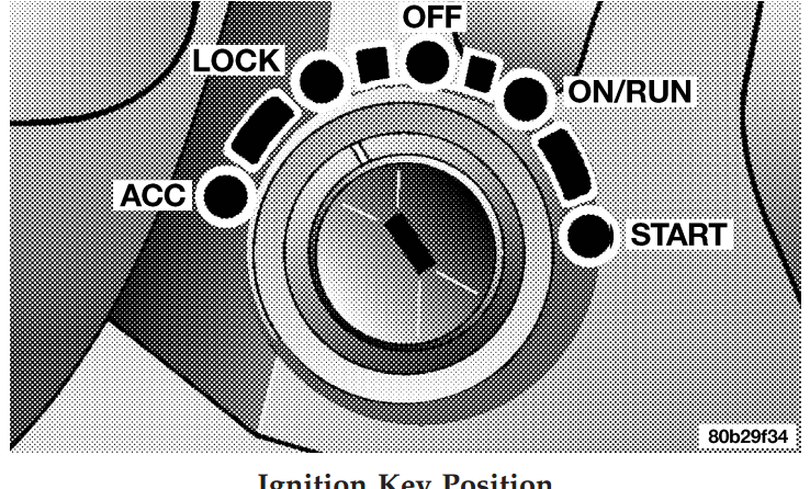

I was able to solve the problem myself. The problem was, that the OFF position of the ignition key is the second but last one. If you turn the key all way to the left it will be in the ACC position, where the key can't be taken out.
Switching it back one position kill unlock the key.

The key is the below.
The dance is the timing [knack] between moves in milliseconds between the OFF and ON position. Brain in gear, patience, it works in milliseconds, practice. NOTE that the OFF is one clockwise from the LOCK position and the LOCK position is the only position from which you can withdraw or insert the key into the barrel.
Picture taken from the EURO issue handbook for my 05 UK 2.8 Grand Voyager CRD and posted on the UK Chrysler forum.

NOTE that the OFF is one clockwise from the LOCK position and the LOCK position is the only position from which you can withdraw or insert ...
correct, I mixed up OFF and LOCK. But what is confusing, compared to all the cars I drove before, is, that there is one more position left of the LOCK position, where you can’t remove the key from.
Does anybody know, what is the purpose of the ACC position?
ACC is for accessory. It's the key position allows accessories only not engine running.
